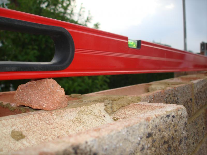

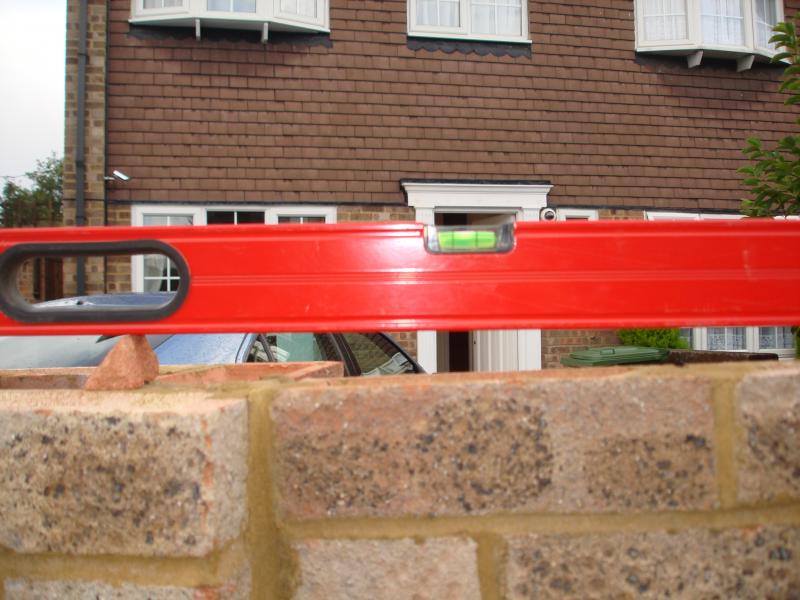

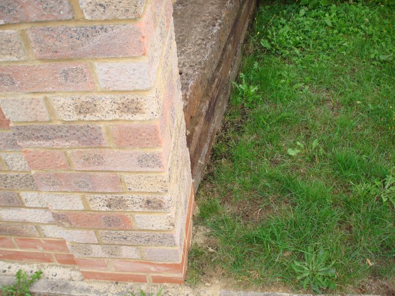

Brick-layer from hell.
So who should pay for the bricks to be cleaned up?

Very poor job. I'm all for diy but you have to pay for time served skilled trademen for some things.
Unfortunately you don't always get what you have paid for. :(
Was this brickie recommended to you. :?:
He's my neighbours son-in-law, who said that he worked on the arches at St. Pancras claiming he worked to a 2mm tolerence.
