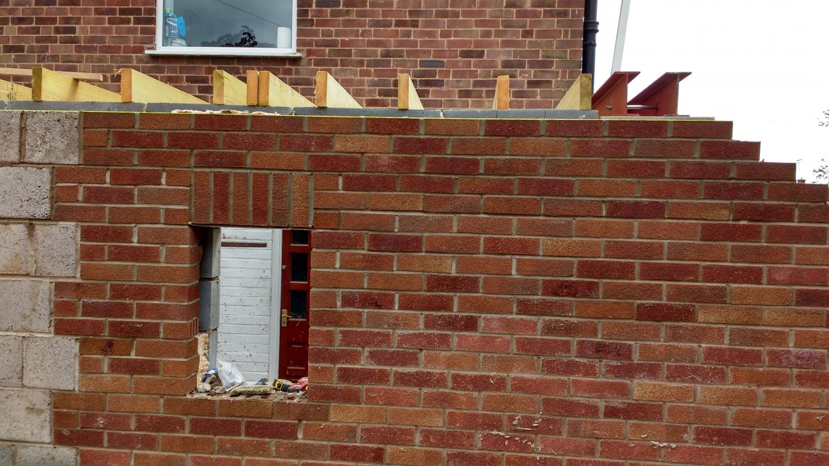

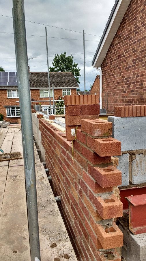

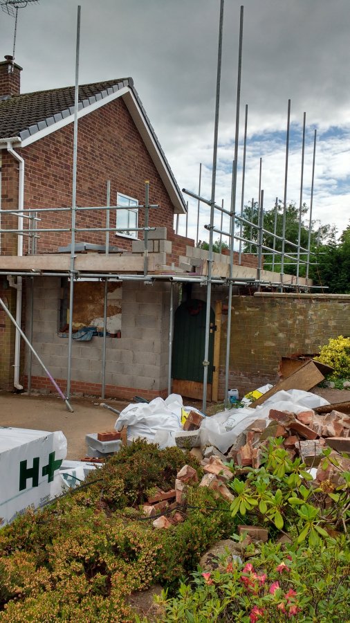

Pics attached. In general I am happy, any feedback always welcome though. I'm aiming to get the gable end and higher up facework as good as I can as it's the most visible from the street :)

You may well be using a plasticiser to get a nice creamy mix, but perhaps you should try a retarder instead?
Or, only get one tub out of the mixer and use that. This will keep the rest of the mix shaded and less prone to drying out as fast. Plus, you can give it a bit of a knock up when you get the next tub.
When you spread the bed, make a furrow so that the brick presses down easily - the bed on the front face should be kept vertical and when squeezed this will be cut off with the towel for your joint of the next brick. But on the back, angle the bed inwards so that none or little gets squeezed out.
But, it's important not to make such a deep furrow so that once compressed, there are voids to hold water.
An alternative, would be to flatten and compact the bed with the towel leaving it just high enough to allow the brick to be pressed gently and then left - 15 or 20mm depending on how stiff the mortar is. Get this right and all you would need would be a slight forward and backward push and the brick will be aligned OK as the bed is already flat.
But see what works for you.
Thanks woody
Good point about trying to avoid squeeze out at the back, I have been scraping it all flush on the cavity side, as I understand it when using full fill dry therm a bit of squeeze out isn't the end of the world ? I know with the rigid boards it's a complete no no
