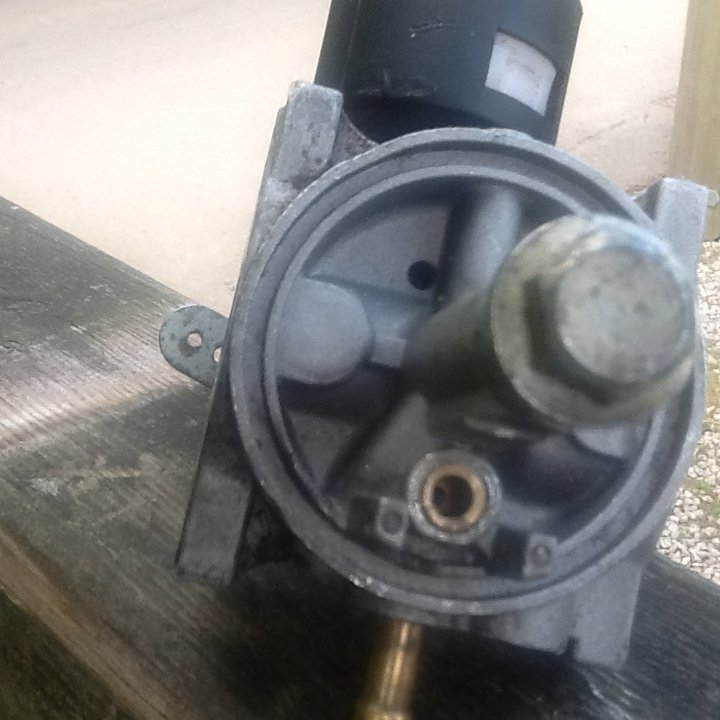

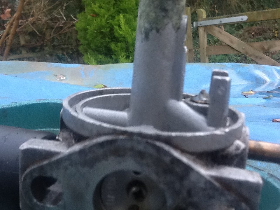

John, found some photos I took earlier. Woo, I might have managed to enclose one! Will try to add some more
- Terry
Valve which was stuck - top of carb upside down
To the centre right (in line with the side of the gate in the background) shows the pointy bit, you can see the marks on it where I tried to remove it with pliers before drilling it out. Tomorrow I'll try to post a pic of where I am now.
Cheers,
Terry.
Wow, that's a new one even to me!
From what I can see, the float needle is in the right way up, as the exposed bit has a sort of flange on it that hooks into the float - so the float actually pulls the valve open rather than waiting for gravity.
I'd guess the needle has stuck in place due to corrosion....the inside of the carb is furred up too.
You'll not get a new needle housing, and personally I'd start the hunt for a carb replacement as soon as you like. Its not a Briggs carb, but there are equivalents to be had.

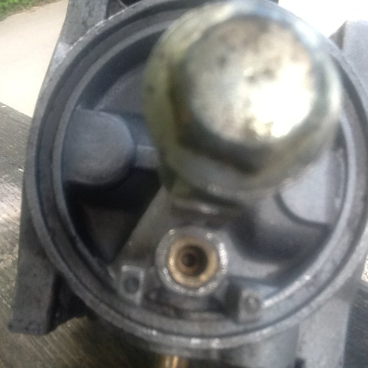

Hi John,
Couple more pics
The collar, the bronze or brass bit is still in. You can see the drilling, the hole in the brass pipe coming in fron the bottom of the pics, at the top of the hole.
The bit I drilled out had a pointy end sticking downwards but no flange at the other end.
Still can't find the float ( I started this malarkey back before Christmas) so it looks like a replacement carb. I'll try contacting the firm you mentioned.
Regards, Terry
By hell, you sure are an ace with the drilling machine (y)
Yep, a new carb is the way to go, but for info, some genuine Briggs carbs have a red rubber seal tucked up in there......the one that comes flying out when you apply the air line :eek:

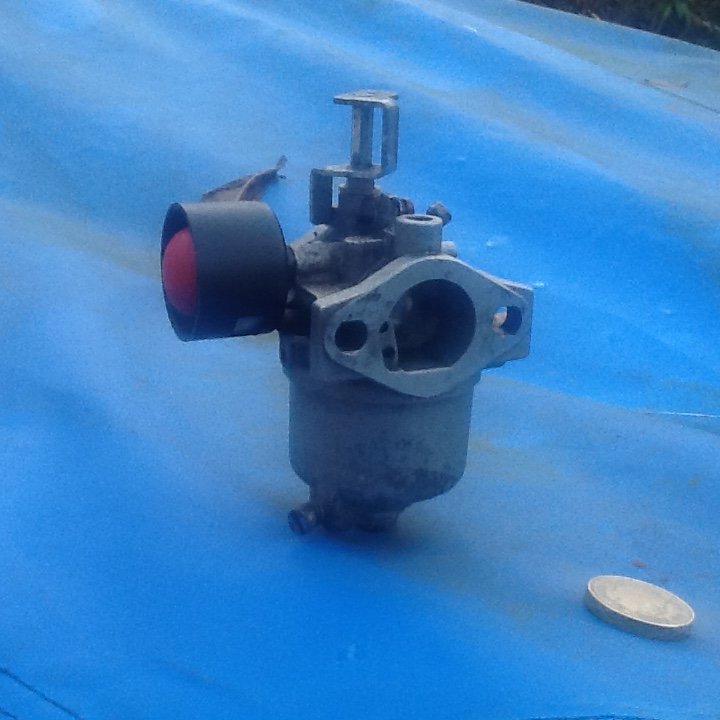

Thanks all. Right then, John, GHS ended up not able to supply a carb but they said there should be something written on the carb. There is, it's "Keruidi". When I searched on that I turned up a picture which looks exactly like what I've got, it's for a Cobra mower, the site was Jungle Busters up in Gateshead, £29, so that's one option.
