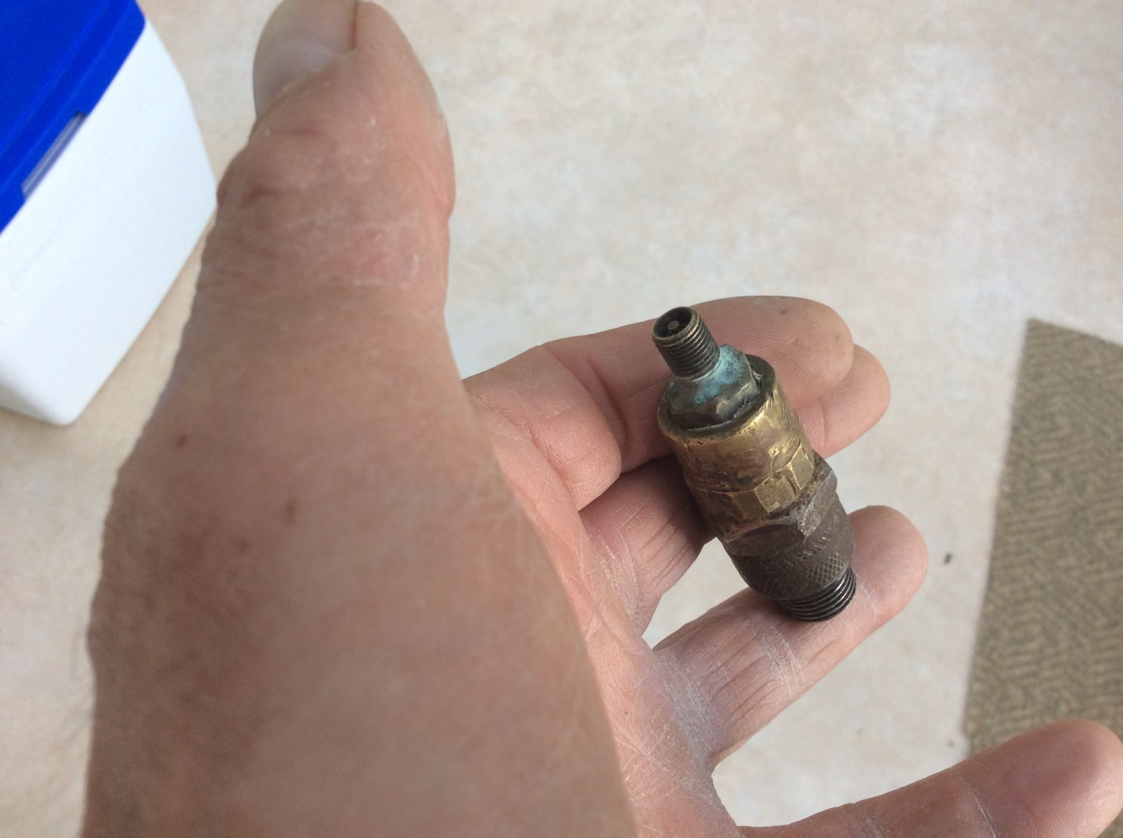

...Ive modified an old spark plug to perform a leak down test as well or instead of 332187A2-F28B-404D-AEC5-CAAE246C232F.jpeg a compression test,these ohv jobbies have a mechanical compression release that may be out of adjustment on the valves?

My new compression test gauge arrived today. the result is 110psi. plenty of compression to start i reckon.
I'm at a loss now.
The plug sparks and the coil is new. The carb is new. The red button squirts into the carb.
I think it's time to revisit the timing perhaps.
The motor pulls over freely every time with the spark plug removed.
It does jam up with the plug fitted every 4 or 5 pulls.
With the new flywheel key locking everything in place and in line, how can this keep happening?
I've read a few similar problems and they point to timing. However if there is only 1 way to fit the flywheel and everything is in line how can it be wrong?
This blastard thing won't win.
