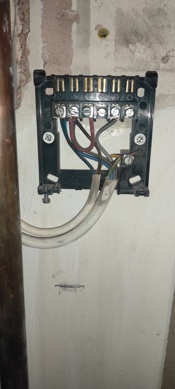

Hi I have also issues with my boiler firing up...and no lights on the wirelless receiver...the problem is that in the picture attached I have the live wire going to number 2, then is like a bridge from 2 to 3 and no black wire going to number 3...what to do to fire the bolier up widhout the receiver? Thx
The diference between ipbr21054 and my one...I dont know if is a good idea to do 3 and 5...please some help thx
.... Noting that they are likely to be at mains voltage and so power needs to be off when touching them, and the cover back on to ensure no bare live wires before switching mains back on.
No you do not, look at the backplate , is says N,L 1234 you linl 1&3
