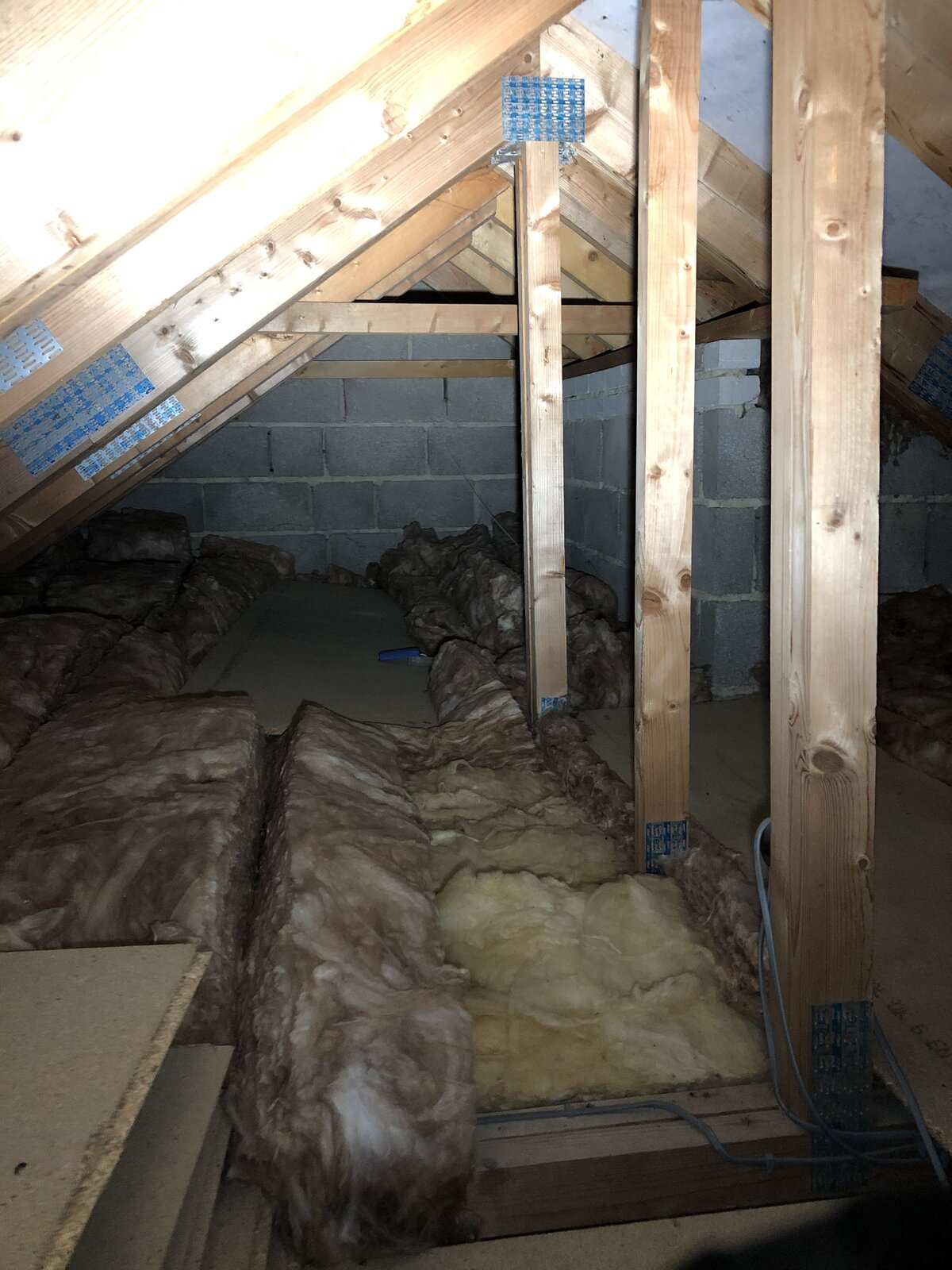

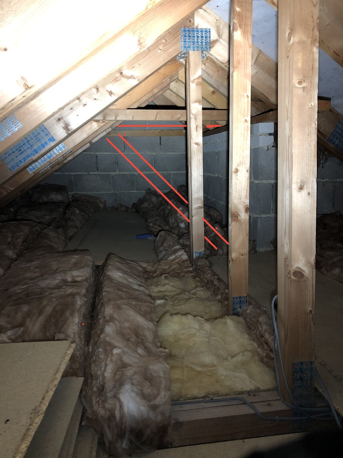

Looking at it again the beam coming up is perfectly square the the walls. The attached point in the apex is not in line. I hope that makes sense as I can’t get a good enough photo to show it so have done a quick and crude drawing.
I see what you are getting at.
So that begs another question - Why did they change the spacing for just that one timber?
The metal jointer looks as if it has been torn apart by a sideways force against the timber in one of your earlier photos.
I know, it is a bit of a mystery as to what is going on. Could the slightly odd/off spacing be due to the velux window on the other side?
The metal is torn but I can’t see how it would have been torn from a force after installation as the lower beam is true to the wall. I can only think that they forced it when installing it to allow it to join up to the top of the roof.

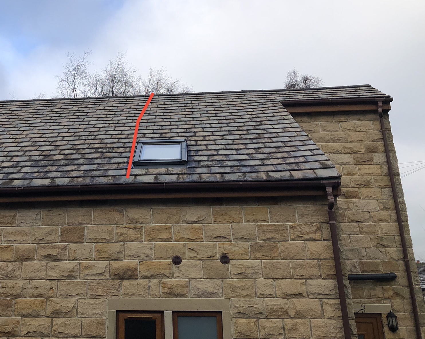

It makes no sense in regards to the Velux on the other side of the roof. Could you take a photo of the roof from the outside, looking at the side the odd timber is on and perhaps mark on the photo roughly where it is?
I agree the metal must have been torn before installation.
This is where the beam lies. To me it makes a bit more sense why they have had to put it in wonkily.
Thanks and yes - I didn't realise it was on the same side as the Velux. Still seems an odd way of doing it though and I would want to brace it.
They could have simply moved the whole structure over to accommodate the Velux, rather than weakening it by breaking the metal joint. The velux cannot have been an after thought, because the first timber up from the eaves is square.

I’m guessing there is some reason that haven’t had in vertical supports so I was thinking about adding 45 degree supports against the wall and each other such as this. Any thoughts as to whether this would be a good idea?
