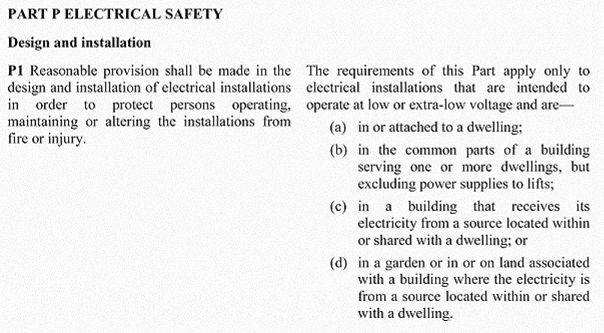

'Mandatory' - I'm sure you put me right on this before and a long post evolved quoting US standards - and what can and can't be accepted to make an installation comply, all very illumunating, however incorrect choice of words on my side, I should have said 'compliance'.
Do I understand correctly that Electrical installations should 'comply' with BS7671, which is formulated to meet requirements of say Part P (Dwellings) of the Building Regulations, which itself sits under Legislation - that has legal requirements.
Part P:
That's it; there is NO more.
The only legal requirement is compliance with Part P of the Building Regulations - which, as EFLI has illustrated, is just one sentence, essentially just saying that things must be done safely.
Most people use compliance with BS7671 as a means of demonstrating/'proving' that they have complied with (that one sentence of) 'the law', but there's nothing in law to say that one has to do that. If one has some other way of arguing that one has done things safely enough to satisfy Part P then that is equally acceptable - but very very few people would attempt that. Hence, in practice, it usually comes down to compliance with BS7671.
Kind Regards, John
