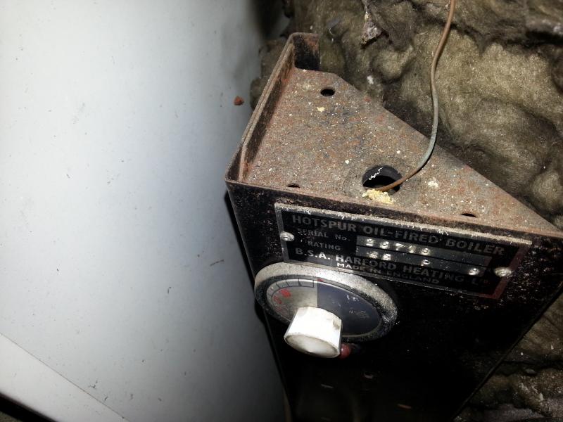

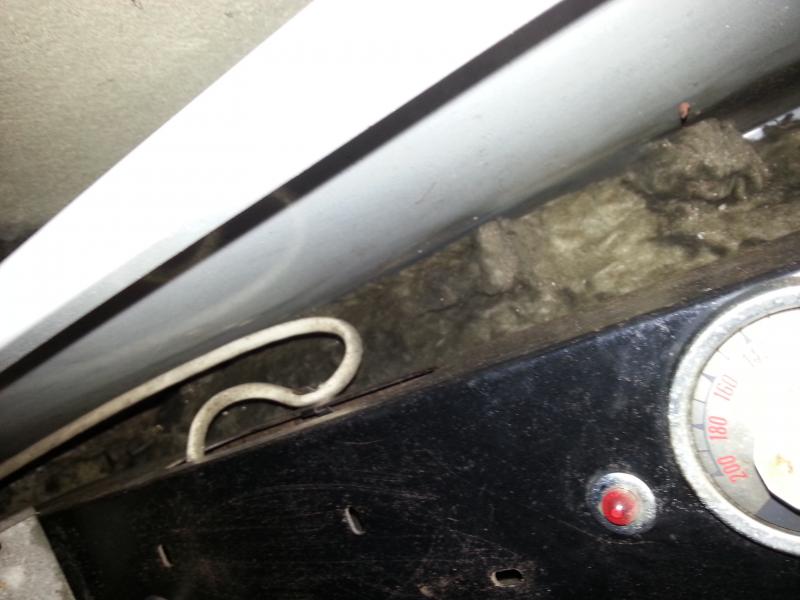

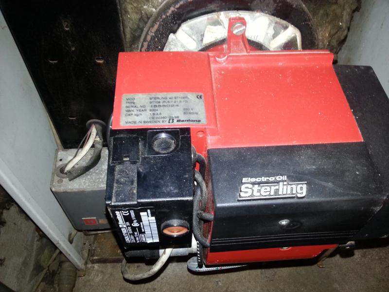

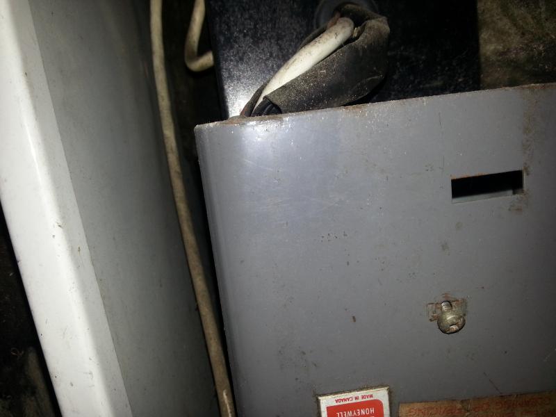

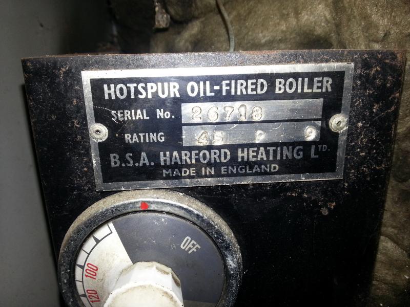

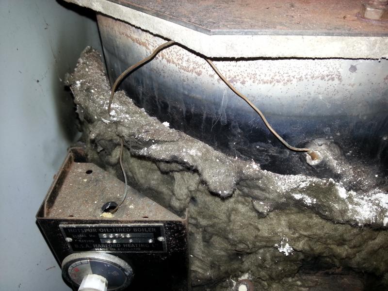

I currently have a Hotspur oil burner which i know needs replaced but funds are low . The thermostat has gone (i think) the burner runs about 25 to 30 times an hour , and I have to turn the thermostat down or the boiler sounds like a kettle that is just about to stop boiling. I was wondering is it possible to connect a Cylinder Thermostat to the return pipe to boiler and connect it instead of the thermo. I will try and attach pictures of the thermo etc they are in my photo album.
Any help would be great including a wiring diagram for the inside of the boiler etc!!
Many thanks in advance
Jonathan

That's an old one Joe, we were fitting these in the early 70s when I started my time. Regardless, the thermostat pocket maybe standard 1/2" BSP or a standard size that a thermostat will fit into.
Post up a photo & we'll see what we think..... ;)

I'd like to think you could get a new boiler thermostat, but the important thing is to establish what size & where the sensor for the stat is?
Photo of that would help.
HTH
If you follow the capillary from behind the knob in your left hand picture, it will lead to the thermostat pocket from which you can withdraw the phial. If you measure this, diameter and length, you should be able to find an alternative at a stockists.
Alternatively, a clamp on thermostat on the FLOW pipe needs only to pick up the two wires attached to the thermostat which is the unit with the knob on in your left hand picture.
