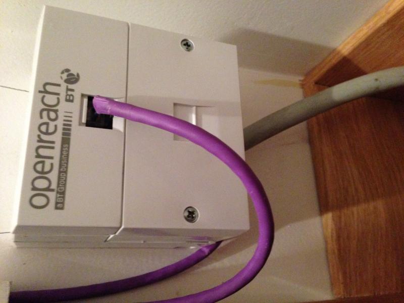

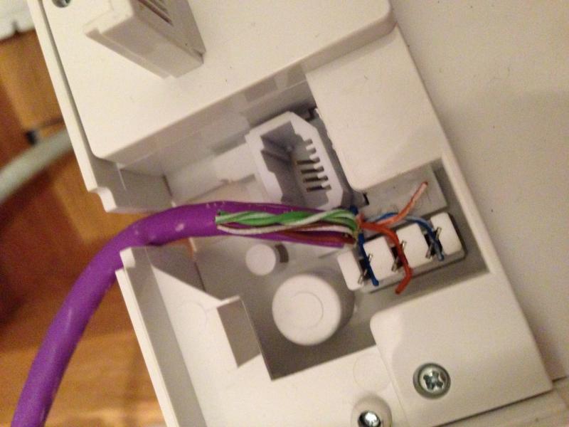

Yeah the pink cable is cat6.
Stranded or solid core ? Tinned or bare copper ?
Stranded wire does not work with punch down IDC connectors. It makes connection to begin with but over time the joints will fail.
I wouldn't really use the term bodged. It is correctly installed
Correctly installed would be CW1308 from the NTE5 to the distribution frame where it would be terminated on a suitable connector.

Done that - and I've come to two conclusions. !. The humming heard after somebody speaks is on the BT line - I can pick it up right back to the mater socket. 2. The interference is being introduced on a run somewhere in the house, it is not present in the rack, but it is at the extensions
In your first post you said it doesn't happen at the master or the patch panel? It does now? Just not as extreme?
Yeah, it seems to be happening, but not as extreme. I think when I first tested it at the master I wasn't paying as much attention as I am now. I think it's best to summarise everything that is going on:
- At the master test socket, I am getting a hum and echo after someone speaks
- At the master filter, I am getting the same effects
- At the patch panel, the effect is slightly more noticeable
- At extensions the hum is considerably louder, and the line volume fades away, meaning that I can't hear the caller but they can hear me
It seems to me that this is a combination of internal wiring and the BT line itself not being great.
If it's any help:
The incoming BT line is an armoured cable, running approx. 15m underground from a new manhole BT built at the gate. That man hole is then connected to another which is another 20m or so away, and thats where the connection is made to the overhead lines. I'm last house on the line, approx. 3-4 mile cable from from the cabinet, and 5 mile in total from the exchange.

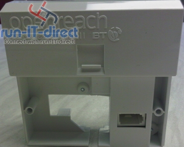

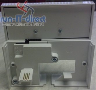

To avoid connection problems, there are replacement faceplates available which have both broadband and voice connections on the rear. (That is the lower, removable section of the plate). They ain't cheap, about £15 each IIRC. A quick web search has brought up http://www.clarity.it/telecoms/adsl_faceplate.htm, but I am sure other suppliers are available.
Using one of these will allow the broadband and voice signals to be separated and sent to the relevant ports on the patch panel with greater ease.
Well currently what I have is voice coming from the back of the BT NT5e, and ADSL coming from a RJ11 plugged into the ADSL out

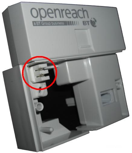

He already has a vDSL filter (the best you can currently get) which uses the existing removeable lower half to terminate extension voice wiring, has an inbuilt RJ11 for the DSL, and also has a pair of UNfiltered (yes breney - a single pair :LOL: ) for the DSL, should you wish to distribute that to another RJ11 outlet somewhere (you wouldn't want to terminate it to a patch panel really).
Thanks for that. I wasn't aware of the two punchdowns for adsl. However, what does this all mean for my phone issues? How will I go about solving them?
Well, by the sounds of it, the first thing to do is report a noises line? You seem to have narrowed to that? Then take it from there.
