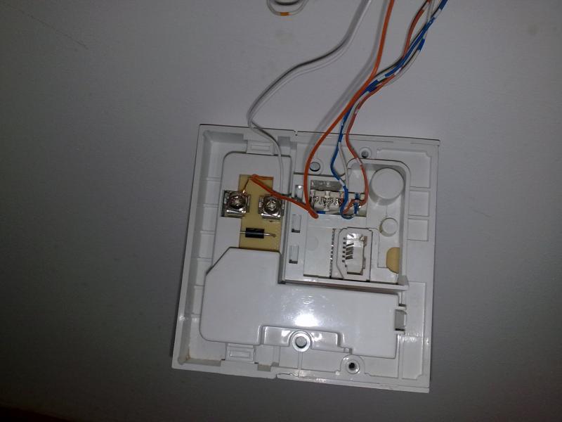

I went back to the customer today. When I dialled 17070 I got the message that this service is not available. I tested for voltage across all the unused pairs on the incoming cable - all were dead. Stupidly I'd forgotten to take my mobile with me so I couldn't retest dialling the two distinct phone numbers.
I'm now heavilly leaning towards the two lines being provided on the single pair. Interestingly, the customer story has evolved slightly. Apparently, at one stage, both cottages telephones were working AND one of them had a working ADSL installation. Would this be possible over a single pair?
If the two numbers are run from the single pair of white/orange do I need a special piece of kit to split the second line from the pair or do I just connect the second line directly from them? IE, from this pic...
do I just connect the outgoing pair for the second number to the same terminals as the white/orange?
No. The DACS system discussed above allows two lines (voice only, not ADSL) to work over a single pair of wires, but they are split into two independent lines again before ever reaching the NTE at the subscriber's installation (the DACS remote units which split the line into two again are some of those black boxes you see fixed on the top of telephone poles or on walls).
As far as the 4-pair cable entering the cottages is concerned, each pair can carry a single telephone line, or a single telephone line with ADSL on it. You can't have two distinct lines operating on the same pair where it's connected to the NTE, with or without ADSL.
So, you know you have one working line (whatever its number) with ADSL on the first pair (O/W). If all the other incoming pairs are dead, then the second line which the owner believes should be active has been disconnected somewhere outside the property, and it's down to BT (or whoever he pays for his service) to sort out.

You cannot 'split' the line yourself.
I would suggest asking the customer for copies of the bills - atleast you can then confirm there are/where seperate lines.
Nothing you can do from here TBH - If they have lost service in the cottages, and the cottages did have seperate numbers/accounts, it is defo a BT only issue.

I've got the bills for the two cottages and there is definitely something strange.
Bill #1 is for the telephone number in the cottage that is working (with ADSL and BT home hub thing) for only £13.21 (£11.50 for "Unlimited Weekend Plan" and £1.71 is "Calling Feature Pack - Call Barring"), makes no mention of broadband and states that no calls were made on this line.
Bill #2 is for the number that is not working. It's for £73.50 all of which is for "BT Total Broadband Option 3".

IF you have two bills there should be two numbers,which ever number you don`t have,ring up b.t and get them to line check it,if what you say is correct there should be a working line in each property which ever one is missing should test faulty.Easy as that.
