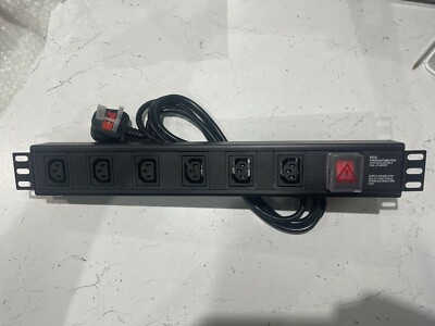

I have decided to do it this way, as I already have a long IEC C13/C14 lead.
I will get the 10A NZ plug to C13 lead. Plug my long IEC lead into it.
Then attach an old C14 lead I have kicking about in the garage to a 6 way fuse and surge protected strip.
I can put a 10A fuse in the strip and then use the 6 way strip either as a short lead or a long one.
Just watch out that a lot of IEC leads are only made with 0.75mm² flex.
Personally for this reason, I would be reluctant to use IEC connectors in an application over 6A.
They do seem to be 0.75.
I shall probably put a 5A fuse in the trailing socket.
Talking of that, I ordered what was described as a 6 way surge protected trailing socket from Amazon. Discovered it wasn't surge protected.
But it has a fuse carrier, which I need.
The version with surge protection does not have a fuse carrier.
I've had a good look all.over, and I can't find a surge protected 6 way trailing socket with fuse protection.
I don't suppose anyone knows of one?
