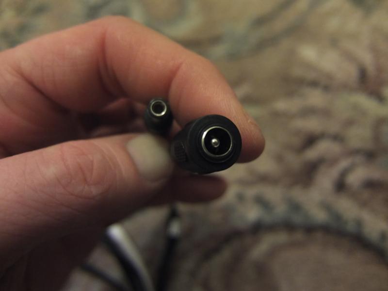

The TV has turned up today and the power lead is too short. Is there any way at all of extending the connections on this transformer:
I will need to cut the wire either at the plug or at the low voltage side to extend - is this possible?!
Could I use one of the following to extend it:
http://www.ebay.co.uk/itm/1-5m-3m-5...t=LH_DefaultDomain_3&var=&hash=item5d4927186d
This is the existing connection:
Will that work? its for CCTV not for this purpose. What about Voltage Drop that i see mentioned in a few places?
Assuming the connectors are the right size…
The lead that is linked to is just a bit of cable with connectors at each end.
It is not CCTV specific, its just been mentioned in the description as a "catch all".
Volt drop will not be an issue for the 1 or 2 metre length the OP will need.

It is a power supply not a transformer and yes you can extend it with that lead.

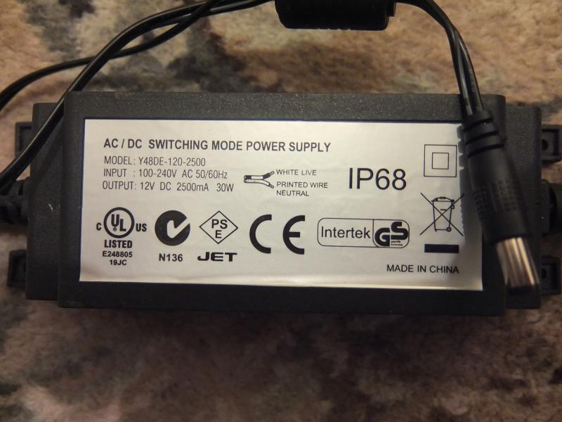

That label has dangerous mis-information about the output lead.
White wire LIVE
Printed wire NEUTRAL
It should be
White wire DC +12 v ( or maybe DC -12 v )
Printed wire DC 0 v
The label suggests that the output cable could be connected to Live and Neutral from the mains. If that happened the device would be destroyed and possibly create a severe risk of fire
That label has dangerous mis-information about the output lead. ....... The label suggests that the output cable could be connected to Live and Neutral from the mains. If that happened the device would be destroyed and possibly create a severe risk of fire
How do you know that the information to quote relates to the output lead? - as we've been shown, the output lead has a moulded connector fitted, so there's no reason why the user needs to know the colours of the cores.
Are you sure the information does not relate to the input lead ('mains')?

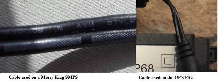

The lead to the ELV ( 12 v ) cable end socket has black and white blocks on one wire and printed text on the other wire. This is a very common style of cable for ELV items coming out of China.
The Merry King plug top power supply has a bogus CE marking along with other suspect bogus certification symbols.
It does not have any indication of its country of origin
Fair enough. The OP's one may or may not be the same. I still wonder why they would bother giving information about the identification of output conductors when there is a moulded connector attached to the cable. In any event, I would hope that anyone cutting off the connector would have enough knowledge to know the difference between input and output.
