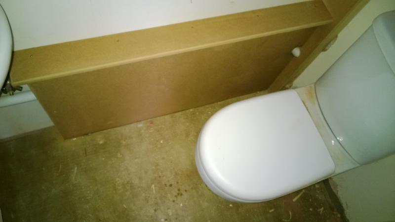

Is there an Earth in that cable?
I certainly doesn't look like it. However there is a gas pipe in the drywall right next to the socket that might have been used as an earth, if that is at all possible. I can't actually check that though.
Did you make the temporary repair, or the carpenter? If the earth is there it seems to have been trimmed right back or tucked away from sight, both slightly odd. Can you see where the cable goes to or comes from and check there is an earth at that end, a socket maybe?
The carpenter did the quick fix. I'll check with him when he arrives later.
I've also just taken one of the sockets off the wall and there is indeed a correctly wired earth in the back of it.

The carpenter confirmed there was an earth which was hidden in the pictures.

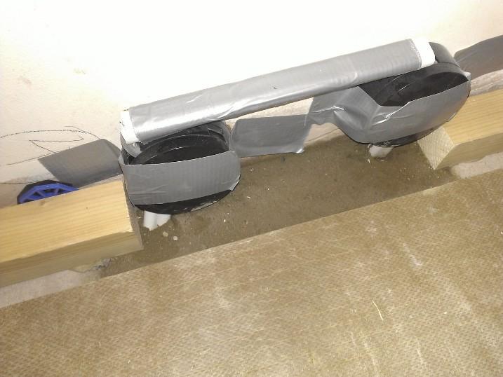

This is what it looked like yesterday when I got home:
Hopefully that job is good enough because today it looks like this:
I guess those JB's are accessible?
Not terribly well fixed to the wall... ;)
