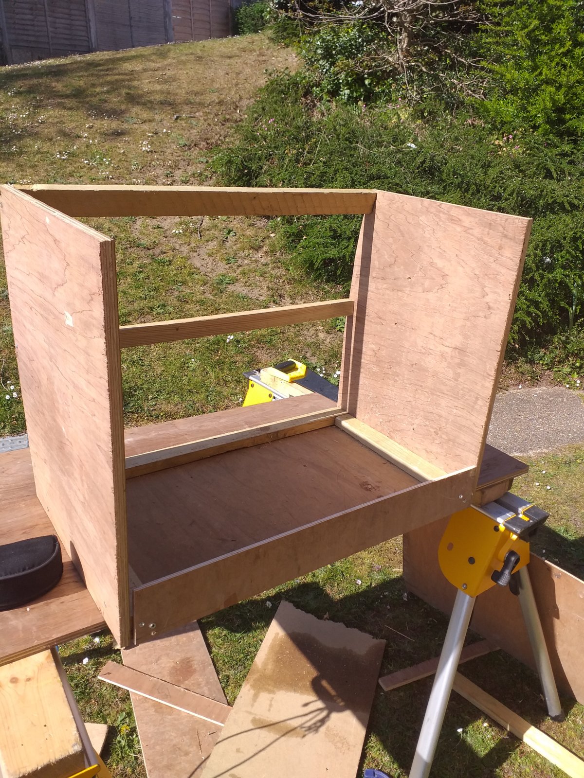

Building a shelf for van and scribing it into van side
When I did the shelves for my transporter I kept the two lower shelves flat with a 60mm front upstand and the upper two tipped back at about 20 degrees and no upstand.
When you do a scribe line the priority is waste as little as possible.

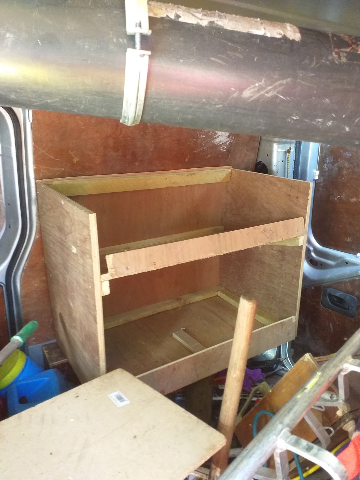

Cool. Mine comes out about 45cm . The sides are about 25cm short of ceiling so maybe could make them higher I guess

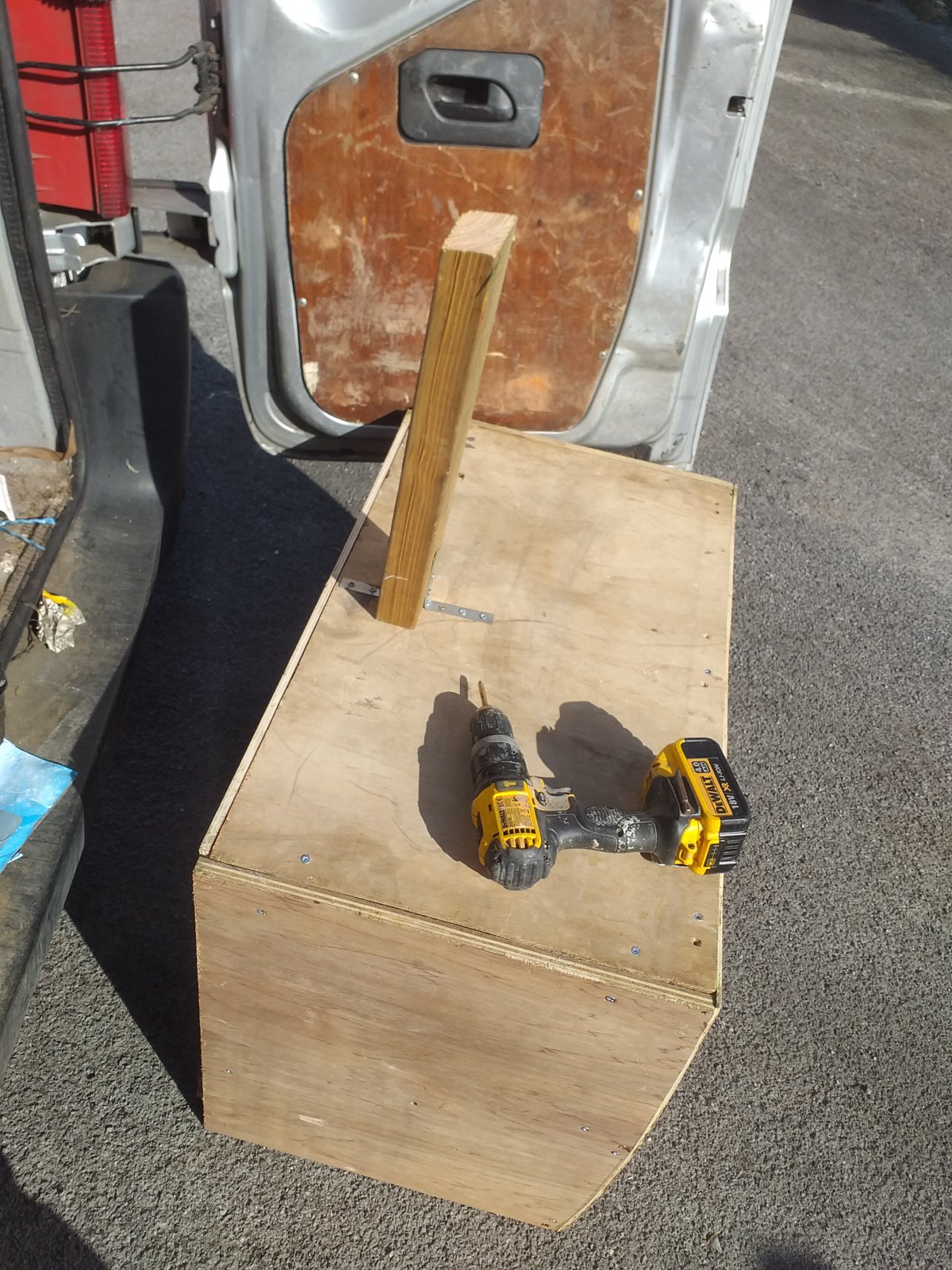

This is it. The weight is mostly taken by the ply over wheel arch. But I put a piece of wood at the front to take the weight from the floor. Could this have been done better? Folding leg on hinges or something
Will put two hooks on wall to attach the top of back?
