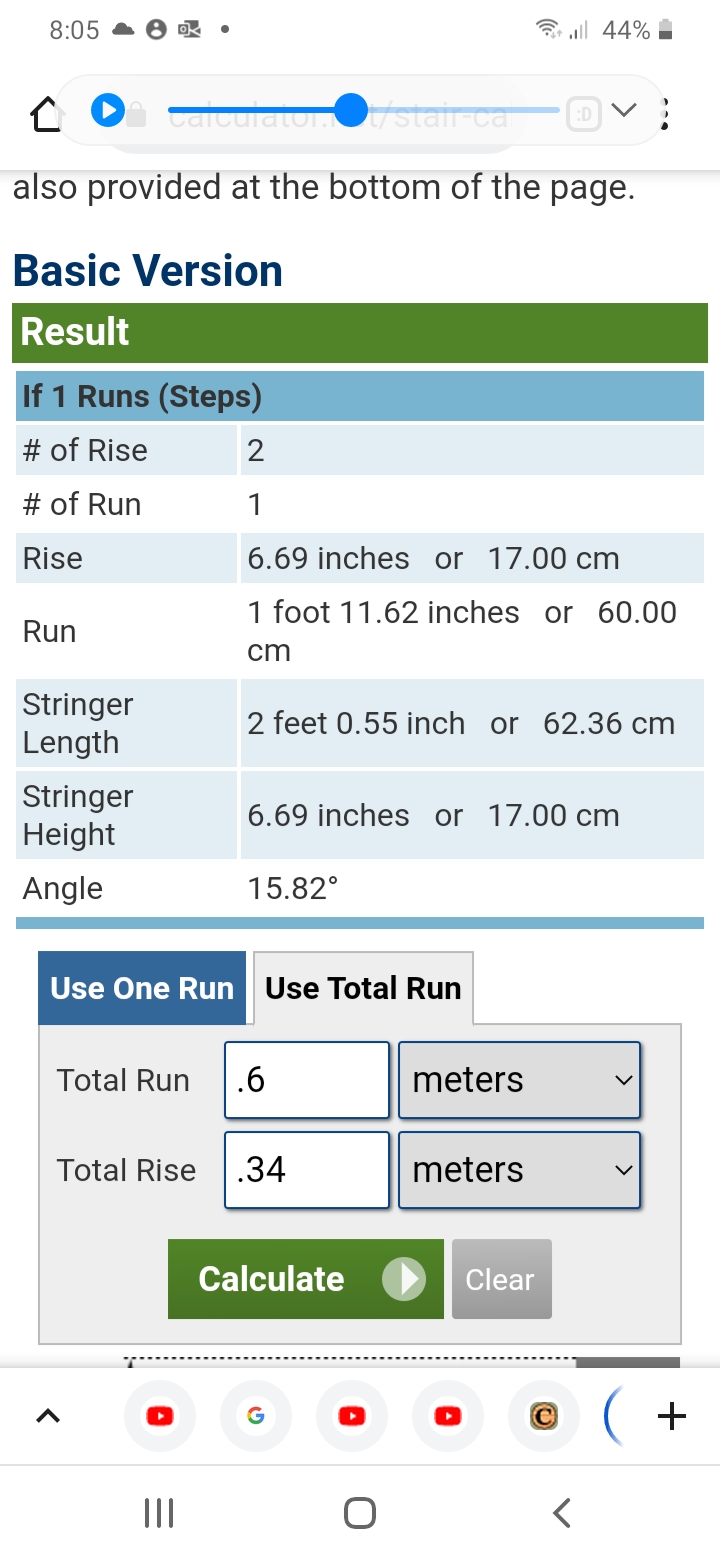

Found this calculator-
https://www.calculator.net/stair-ca...talheight=.34&totalheightunit=meter&x=84&y=16
I put in 60cm for total run and 34cm for height.. think I read under regs that with a total height of 34cm would need two steps down

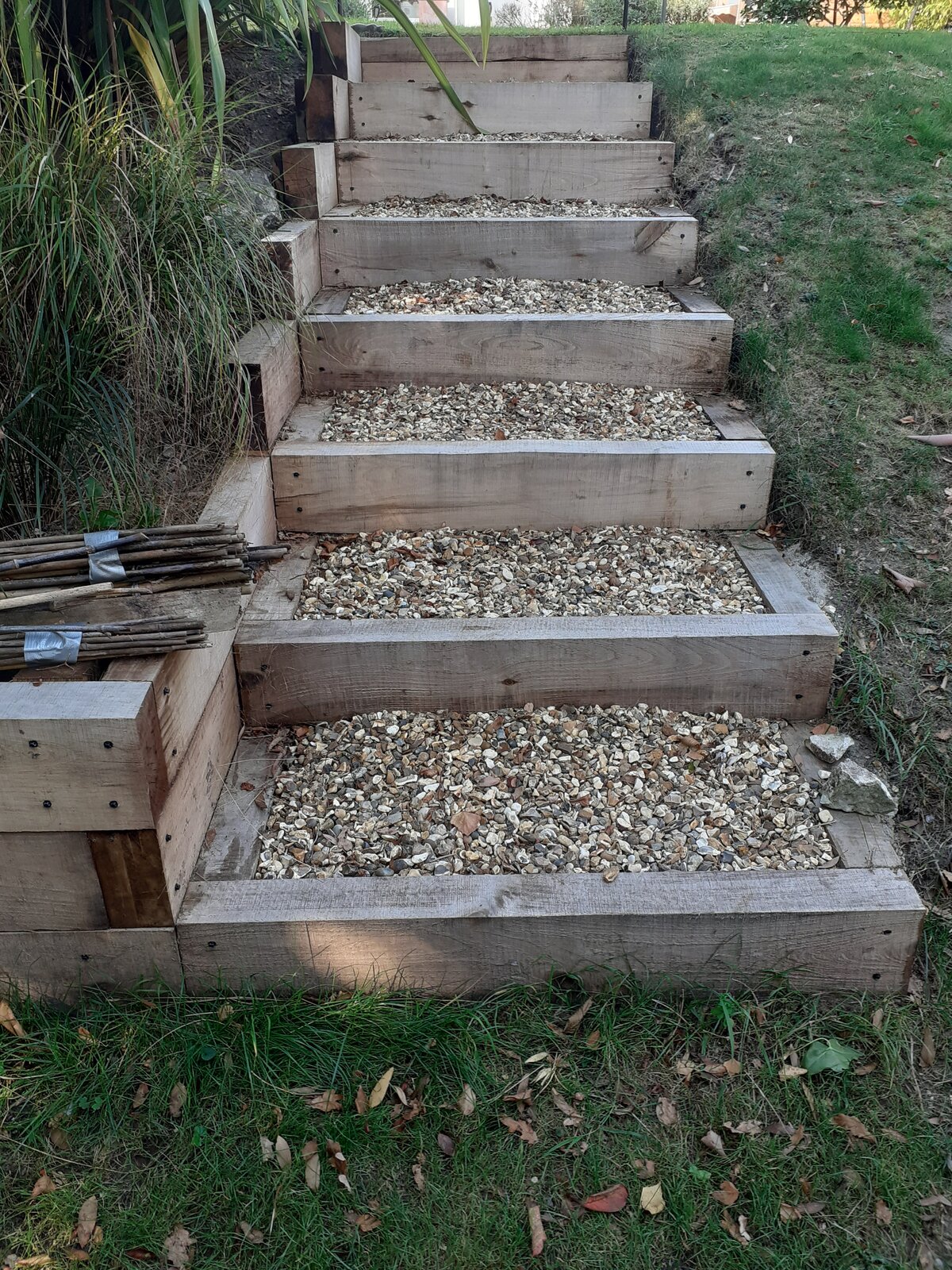

Been thinking about the rise (height) on steps . Think the regs say no more than 7 inches high. Yet these are 8 inches . Is that a liability case against the landscaper? Not me.
Been thinking about the rise (height) on steps . Think the regs say no more than 7 inches high. Yet these are 8 inches . Is that a liability case against the landscaper? Not me.View attachment 244411
are regs different for external landscaping?
the regs i know of (maybe for internal stairs, not public) are not more than 225mm (maybe 220mm) for the rise or going and not more than 42deg
