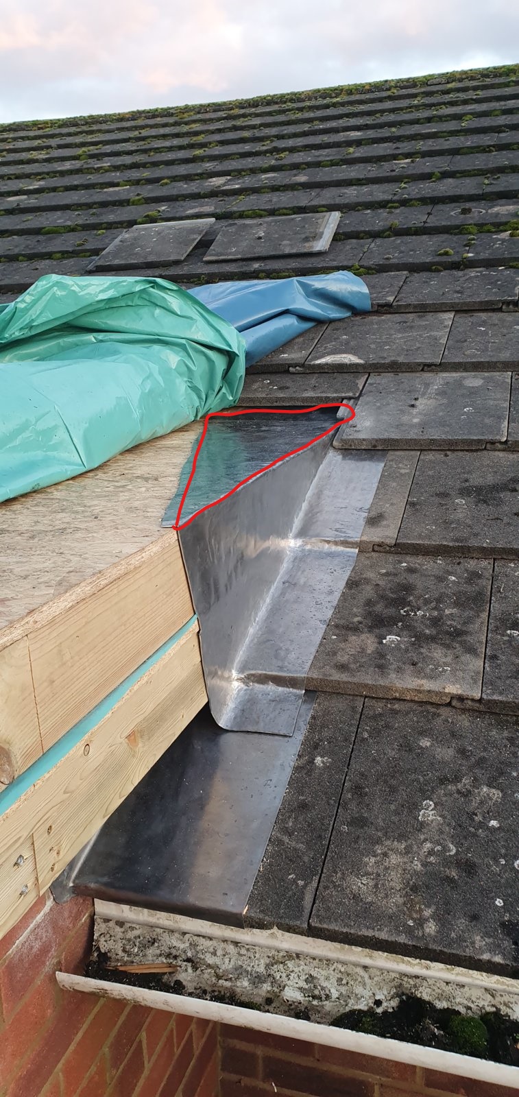

Once you have taken a few course of slates away to reveal the wall plate for your new roof joists to sit on, you will then have to lay some board up the rafter slope approx 1 foot which you will then have to slate down to.
A few pictures may help.

That first tile batten does not need to be notched if its not fitted on the extended plyboard

Large box of 100mm screws, rubber is a good choice as it makes a good tarp, especially at this time of year! 11mm osb will suffice over the joists and up the roof. You will need to go further up your rafters with the osb being a warm roof.
I always use 18mm t&g for the top deck.

Question i have about the lead work where the flat roof meets the pitched roof. This picture has been taking from the net. The question i have about it is, is there any need for the lead to be sitting on top of the ply. Would this not have issues with the vapor barrier and the EPDM when installed on top.
