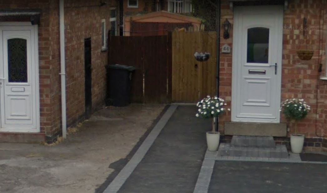

As you can see from the below Google Street View grab, my property is on the right. The deeds show a clear boundary marker right down the centre of the driveway meaning it's not a shared drive. The deeds also show that I am responsible for the right-hand side of my boundary and not the left as show below. Can I build a fence along this boundary legally and within requirements? I'm happy for it to be "their's" as I'm effectively maintaining their boundary, but I just can't find a clear answer online.

As far as I understand it, you are free to build your own fence so long as it is on your land. They should manage the boundary where there is a fence/hedge etc. but if you don't like their boundary, you can put your own fence up. Same as if they had a chain link fence in the garden, and you wanted to put up your own panel fence. Means you effectively lose some land to having a fence that the neighbour should put up, but I don't see any reason why you shouldn't. People walking across your land is a PITA.
The only issue is if it is declared as a shared / party boundary on the front drive. Then you'd need their permission to put something up, I think ... hopefully no mention of that though.

It looks to me, like you removed his fence and damaged his path, laying your new drive way. You really should have re-instated his fence when you had your drive done. As now your only option is to put a fence on your land up to the boundary, which I'd suggest is a maximum of 1cm to the left of your block edging (based on the rest of the boundary fence)
If you put a fence on his land - he can remove it. If you further damage his land doing so, he can claim against you.
I think a fence like the one you already have on the other side is your best option, particularly if the drive fronts to a classified road - restricting the height of your fence.

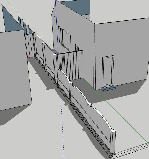

So... as per @jonbey 's suggestion I like the idea of a couple of 6ft panels and boards down the side of the house then dropping down to 3ft fencing to the end of the drive. I'll also be installing a gate at the point of transition so I have an enclosed/locked area down the side of the house.
I will run the fence down the line of edging bricks on the left of the above picture. They are wide enough to allow me to remove and drop a fence post so I don't need to cut through tarmac. but I'm not sure of the right approach to removing. They were laid on a bed of sand/cement and obviously flanked by the tarmac.
This is a (poor) rendering of my final plan:
