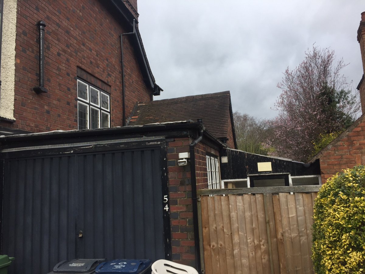

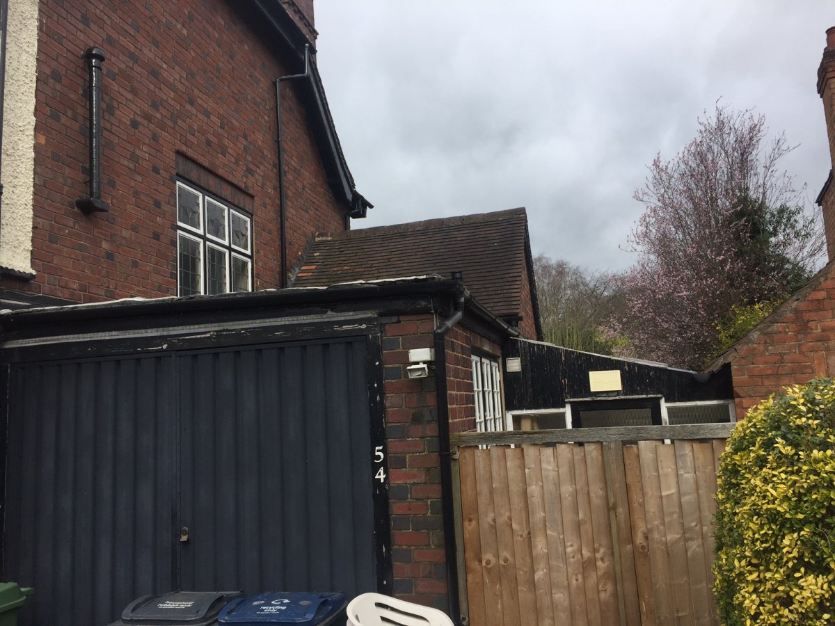

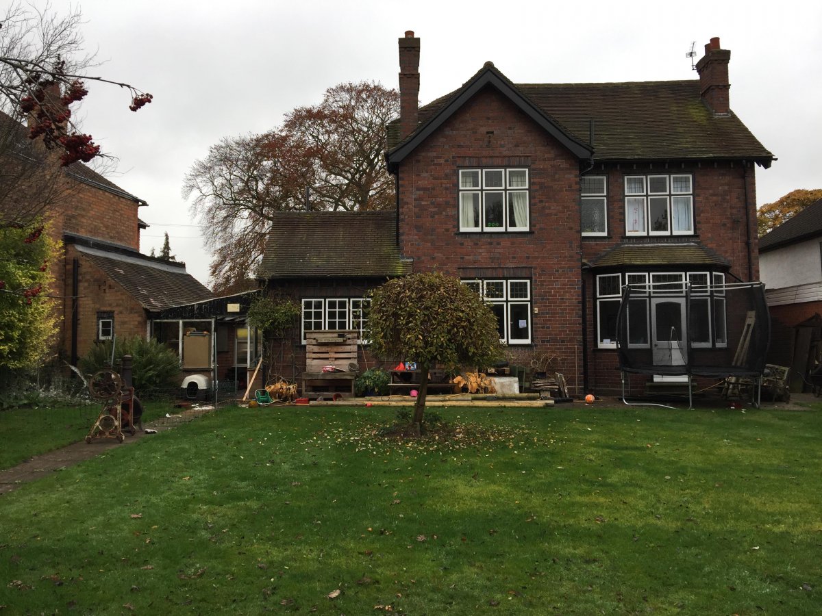

If you look to the right of the garage doors you'll see the fence that currently blocks off a small yard before the outhouse and lean to that will form the extension. The porch will be a good foot behind the fence.

Don't know if my wires are getting crossed here, but the porch is behind the front wall of the house. In fact any part of the front of the house. The outbuildings I intend to convert aren't attached to my house. It's a side extension that stops just under a meter from the front.
So you're adding something to the front of an outbuilding? Not your house? In which case it's NOT a porch!
This is where I think the confusion lies. Currently my house has a front door and a porch where we enter. This side extension is for the kitchen. I intend to stick an additional porch/entrance/boot room whatever you want to call it on the extension so we can go straight into the kitchen after dog walks instead of through the main hall/house.

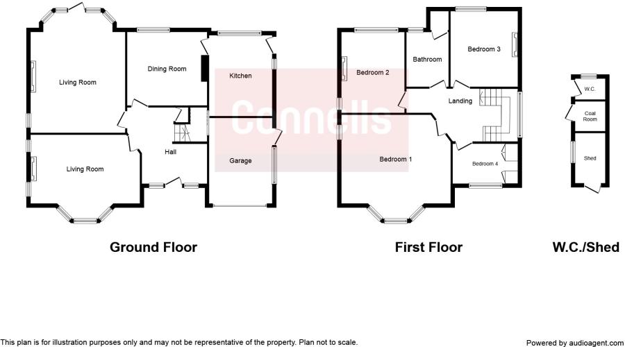

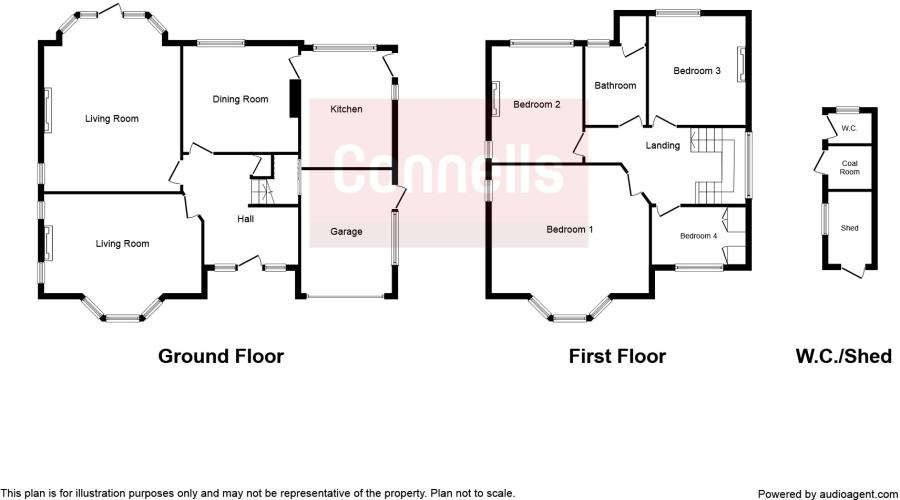

It would be *much* clearer if you posted a set of original (1948), existing and proposed plans for the dwelling.
I don't think it is PD. You appear to be extending forward of the 'lean to'. If you are arguing that the lean to is not part of the original house, then you are extending over 50% to the side of the house.

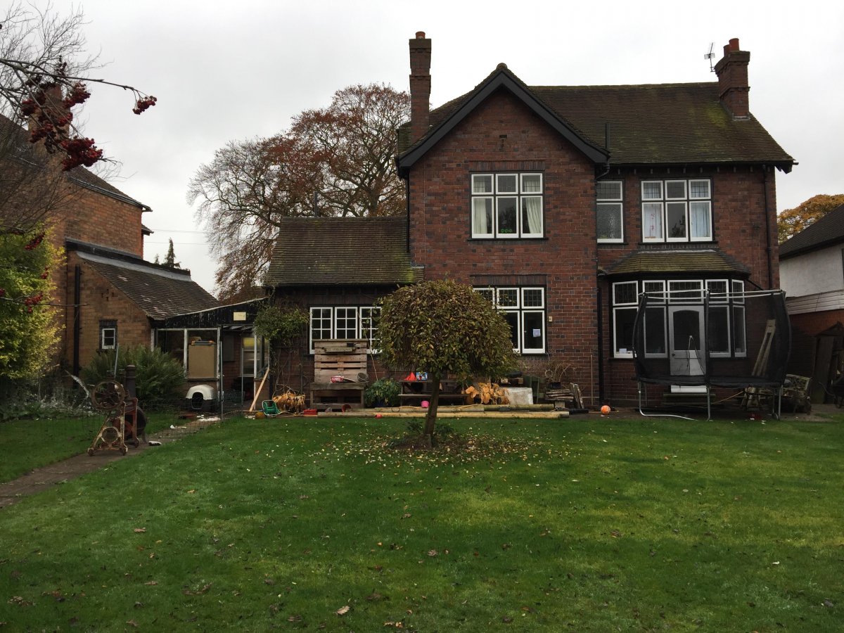

Here are the floorplans as the house was sold to me 6 months ago - the lean to (just some timber and corrugated plastic roofing) joins the brick built WC shed (which I refer to outbuildings) to the house. They sit back approx 2 m back from the front of the house. The actual back wall of the W/C/shed is in line with the back wall of the kitchen floorplan.JPG

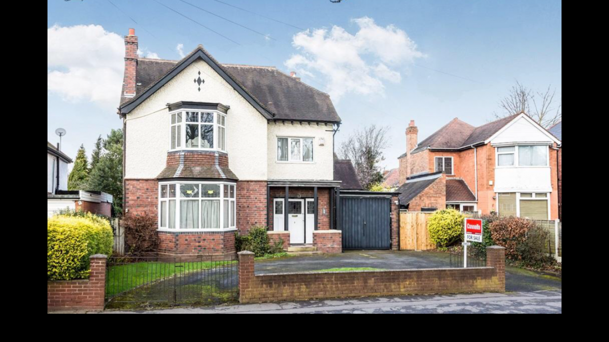

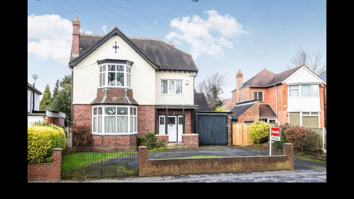

Struggling to see how your sketchup drawing relates to the house; assuming the garage in the sketchup is the same thing as the garage in the front of house pic?
Yes, the garage in the sketchup is the same as in the front of house photo
