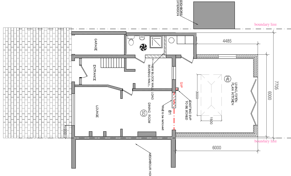

Hi All.
I recently had the building regulations approval come through for my extension, albeit with a lot of conditions which I do not understand why, however the one that worries me is the open plan and loft extension.
Several ground floor plans have been provided, please sconfirm which is correct. Note: the
open plan layout will not be acceptable where a loft conversion is proposed unless
additional measures are provided to show compliance with Part B.
What happened here is that, I had to submit 3 planning applications.
  1. 6m single storey rear extension
  2. Hip to gable loft extension
  3. 3.5m rear extension incorporating a porch and converting the garage to a habitable room
All the 3 planning applications were submitted at different times, and as such the building regulations work was split into 3 document but submitted under a single application.
Please ignore the conservatory part in the drawing below. The below is the first floor and also the proposed loft.

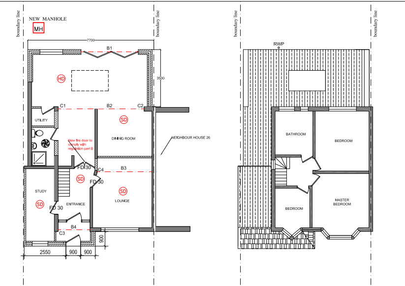

The plans you have shown are not open-plan type.
As such, all you need to do is to fit interlinked smoke alarms/detectors on each landing and the ground floor hall, plus fit fire doors to all habitable rooms opening on to the staircase enclosure;
OR, forget the fire doors and fit interlinked alarms in each room and landing.
How about just confirming to them which one "of the several" ground floor plans are correct?
On the ground floor plan shown add an interlinked smoke detector to the entrance hall and a fire door to the dining room. What do building control say about egress (fire escape) windows :?:

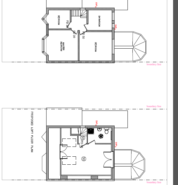

Thanks for this.
to be clear, it will be the 3 rooms on the first floor and also the door to the loft area that needs to be a fire door i.e FD 30. The plan is to then have 4 smoke alarms, as per what the architect has now put together. He has also put a fire door from the hallway leading into the extension. Please ignore the fact that this drawing shows an extension of 3.5m, its actually 6m as shown in the first drawing i put up.
Please look at the latest plan posted above this message, will that suffice, see the new fire door by the hallway.

You require your architect to provide ground , first and second floor plans exactly as proposed ( no please ignore this or that :!:) showing fire doors, smoke detectors , heat detectors and egress windows and get these approved by Building Control. The architect should specify the requirements for the egress windows to ensure the window types , cill heights and clear opening sizes comply with Approved Document B.
