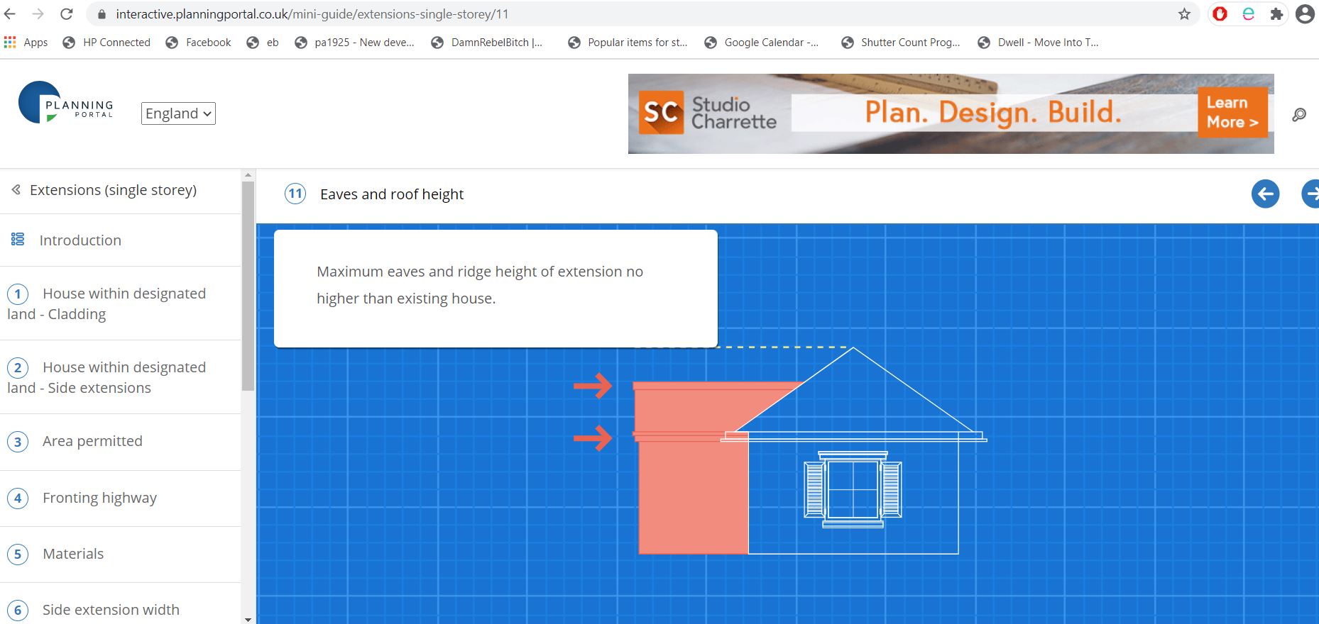

The diagram is only correct for a pitched roof extension; it would have helped had they explained how it works with a flat-roof extension.
Rule A.1(d) of the GPDO states that it is not permitted development if: "the height of the eaves of the part of the dwellinghouse enlarged....would exceed the height of the eaves of the existing dwelling house".
For a flat roof extension, particularly with a warm roof, the rule would require a particularly low headroom in the extension.
The Planning Portal mini guide shows this, so the existing roof altered is PD?

I had that conversation with the planning officer and she conceded that under her interpretation you effectively cannot ever extend a bungalow under permitted development and was quite pleased with herself. Planners hate us plebs having the freedom to build things without their approval.
After Designgrey posted that very helpful illustration I decided to go back to the technical guidance and have a re-read. The Planning Officer in my case was quoting alteration to the existing roof under A.1 (k(iv)) for it not being permitted development.
However the technical guidance specifically says that an extension can join the existing roof provided it meets the requirements of Class B. (see below)
I don't know how I missed this the first time D'Oh! It seems fairly conclusive to me. Under Conditions there is also an illustration for A.3 (c) (page 32) showing a two storey extension with the pitched roof of the extension joining the roof of the house as added evidence.
