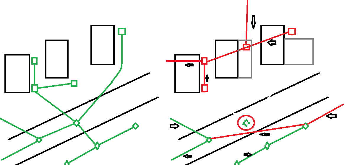

building within 3m of public sewer
Today i have had a pre build drain inspection in order to confirm the location of the sewer which is shown on the drainage map provided by Southern Water,
It turns out that the sewer shown on their map, running parallel to my proposed extension inside my neighbours boundary is non-existent.
My drainage joins the public sewer approximately 20m from the rear of my property, the sewer then falls to the right for at least 30m more.
I haven't had the report back yet but this is just from speaking with the guy doing the survey, is this normal for the sewer map to be so wrong?
At my daughters house the official map shown on the left in green, what we eventually found in red. Note the chamber in the middle of the road circled in red was there but nothing connected to it

We eventually got the drainage plan back after three weeks and i'm very happy to say that it does indeed confirm that there is not a public sewer within 3m of our proposed extension. While i'm glad that we didn't have to shell out for a build over and anything else that goes with it i can't help but feel a little irritated that i had to cough up £300 to show that the sewer plan is wrong.
We've also got an independent building inspector on board and have the green light to get started.
