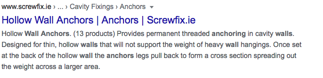

Thanks Eamman. Coz they are on the shelf next to the Plaz I thought that's what they were for.
