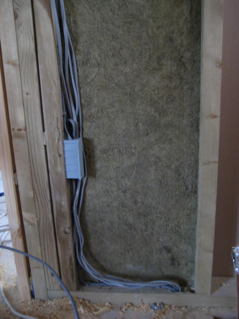

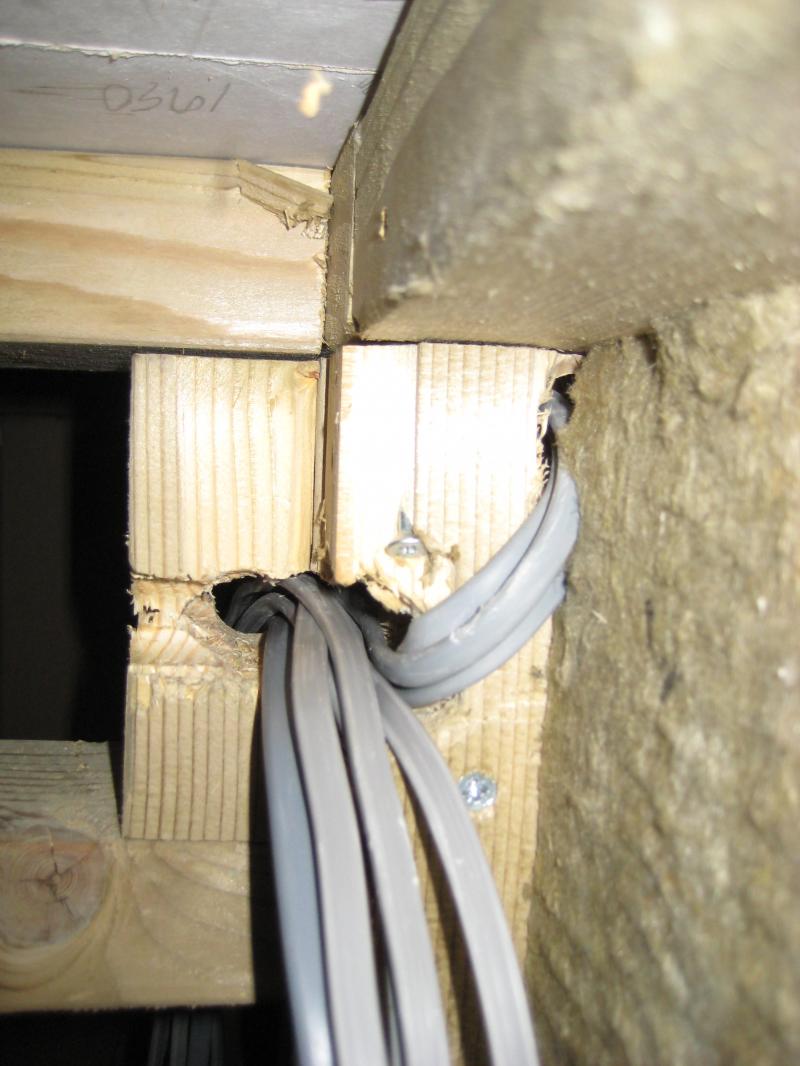

Hi,
I have 6x 1.5 and 1x 2.5 T&E threaded through a hole cut through 3x 2x4 stud wall timbers - all timbers fixed together to form one thick post, the cables form quite a bunch, I understand cables that are in conduit need air free around them to 'breath', 55% free (45% for the cables - this article refers: http://www.tlc-direct.co.uk/Book/4.5.3.htm ) does this rule apply in cables through timbers - as the length is only 150mm or so ?
The stud has 50mm insulation friction fitted, so I have cables also run in the other 50mm void.
The bunch of cables then run inside the stud wall, they are not in the safe zone, run in 25x38mm conduit inside the stud , so are not 50mm from the surface - I assume metal capping one side would suffice to satisfy Regs.(dont need any other side as that is 50mm from surface.
I also have a spliced cable in the stud that will be sealed up behind the plaster board - the splice is contained in a MF BS7533 Wagobox. But with the insulation the Wagobox again is not 50mm from one side of the stud, would a small length of metal capping satisfy Regs.

Unless the hole in the timbers is ridiculously large, I'm sure that what the OP described will qualify as 'grouping' per the regs. One of the problems with the regs in this area is that, unlike the situation with cables passing through insulation, (and unless I'm missing it) the regs do not appear to have anything to say about the situation in which only a very short length of the cables is 'grouped'. I'm sure that such 'short grouping' (e.g. where cables leave a CU - or, indeed, when two or more cables pass through a small hole in timber, as per the OP) is very frequently 'overlooked'.

It general, to escape from any degree of de-rating for grouping, cables have to be separated by a clearance of at least 2 cable diameters. That is clearly far from the case when cables are literally 'bunched'- e.g. to go through a hole. However, as I've said, I suspect that may often be 'overlooked' when the grouping affects only a very small length of cables!

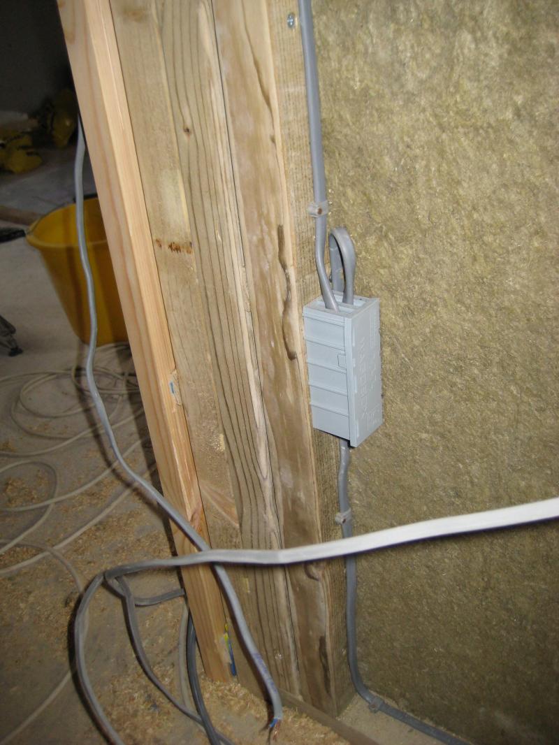

Ahh yes, sorry changed on of the permissions.
Bunched cables - 100mm max length.
Wagobox in front of insulation:
Rerouted bunch that need to go in trunking - as I am classed an ordinary person installing ...
Does the electrical trade use the term 'competent' person, and would he need to be under the supervision of a Trained person ?
Those cables are not routed within prescribed safe zones so will need re routing or installing inside steel conduit.
