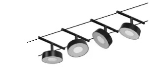

I have read, and often ignored warnings on lighting transformers that the extra low voltage wires are limited in length,
These lights are no problem when the supply is ELV 50Hz from a wound transformer.
The problem arises when a switch mode ELV supply is used, The RF radiation is high enough to affect radio comms a mile away.
A sea side picture gallery "up graded" to dimmable ELV supply, marine radio comms were affected when the light were lit.
