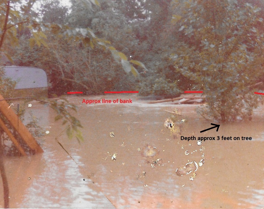

Sadly no, but came very close to it at the previous house, built the wier and the mill race but never got round to solving the problem of the flash floods. It needed a mechanism to lift the wheel clear of the stream to prevent it being washed away after heavy rain.
This was the flood while building the house
