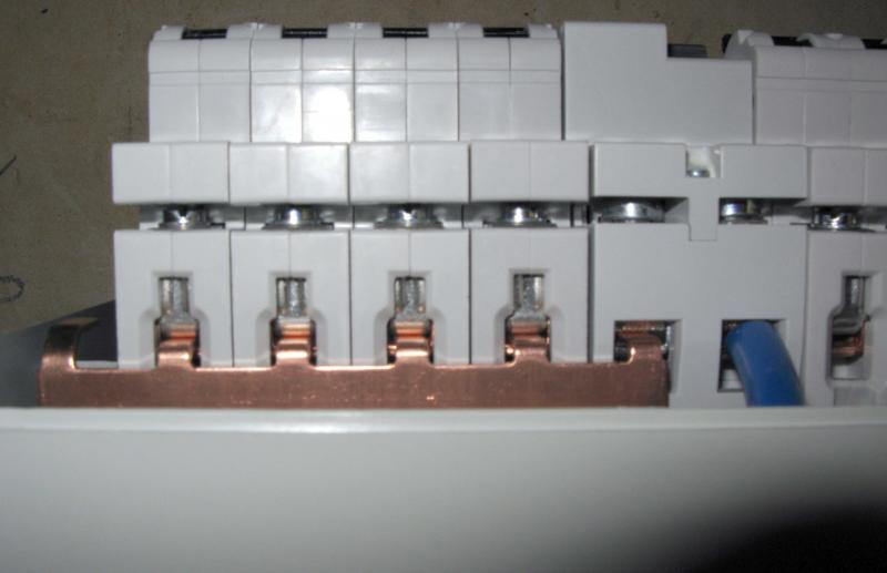

Howdy Pardners,
I've got a Wylex consumer unit with 'flexible bus bars'. Each piece of bar has one cranked pin at the end that's supposed to slot into the RCDs/Main Switch. But because it's cranked - offset a little compared to the other pins - when you tighten down on it the MCBs are pushed away from the DIN rail out of alignment with the RCDs. AFAICS it makes no sense for the end pin to be 'cranked' like this since the RCD live output lines up perfectly with the MCB live inputs. Any idea what's going on here? I can get away with cutting off this cranked pin because I dont need 5 circuits on either of the RCDs, but how come it's like this in the first place?
Here's what the bar kinda looks like with the pins facing you - 5 pins and one 'cranked' 'supply' pin at the end:
- - - - - _
UPDATE: here's some photos.
Terminals line up:

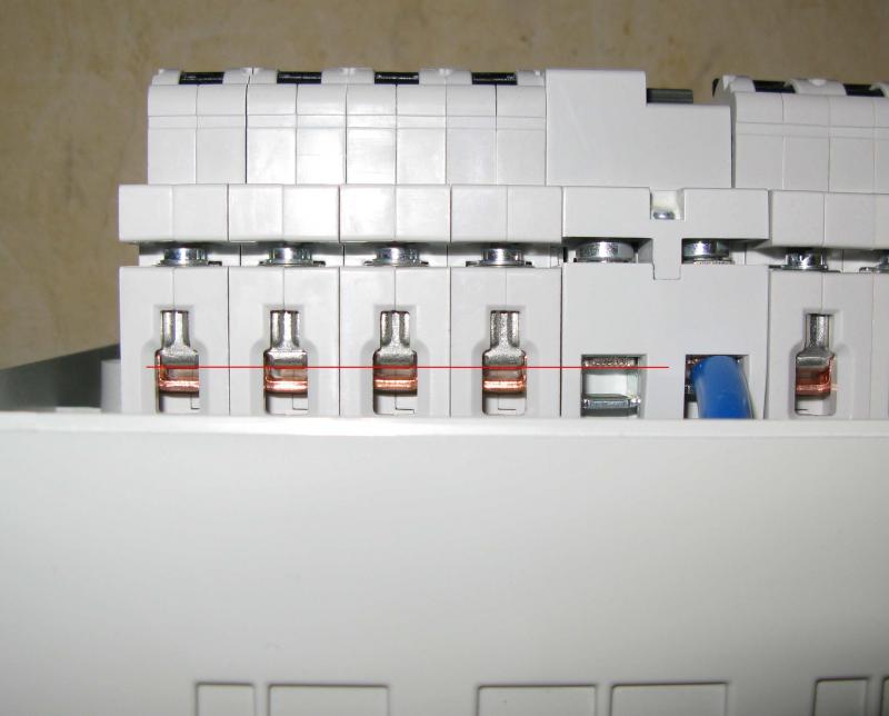

Looks like main switch might be offset.
With bar fitted, MCBs are pulled out of line.

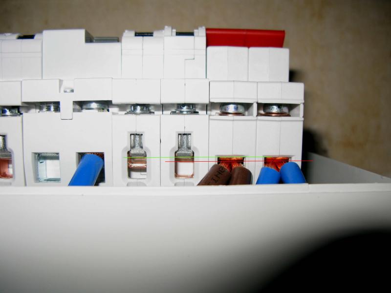

Unclipped, the MCBs are way off.
Cheers. [/img]
The offset is right, but I can't remember where there is a required offset. It might be for the main switch down to direct circuits such as rcbos.
Although (and it's been awhile) are you sure the offset isn't for the rcd down to mcb.
Do check, because I'm sure there was an rcd where theres a cavity that looks the right place for the bar prongs is straight, but isn't.
If you are right then get a straight rail that has enough ends to cover both used and any spare ways for future use. You can straighten then out with heat and grips or a vice, but the prong offset might not be in sync with the set.

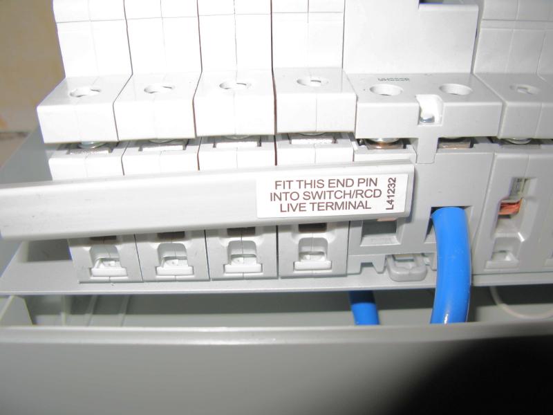

Are you using the very latest style of MCB ? Post a pic.

Cheers folks. I've added some photos to the original post.
This is a Wylex kit with MCBs and an RCBO supplied. I can't see how these bars are right. They are all the same and look like suitable for connecting the main switch which is offset (makes sense given your comment Chri5), but otherwise they just don't line up. Normally I'd always assume I'm being the eedjit, but in this case it looks like a cock-up? I'll phone the support line in the included material.

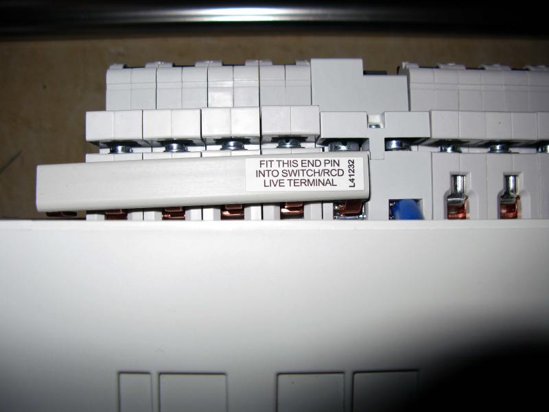

Can you explain the last photograph a bit more? It looks OK it that one, but not sure what you have done in that one.
Many consumer units can have these problems where the MCBs are quite crooked, and it doesn't look too pretty in your pictures.
Very often things do move about, and fitting the lid does seem to straighten things up. Hardly satisfactory from an engineering point though, is it?
It would be worth contacting Wylex. Maybe a busbar without a crank is the answer.

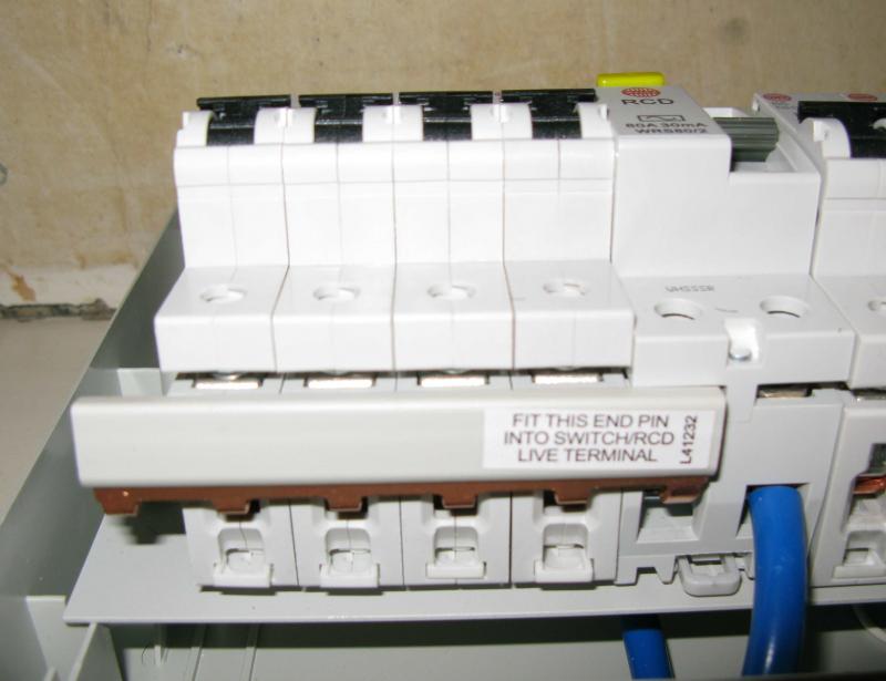

That last photo above is with everything tightened up but the MCBs unclipped from the DIN rail so they find their own position - they sit a good 2 or 3mm too high
Couple more pics:
Bar flipped to avoid using cranked pin - looks correct.
The bar with insulation off:
