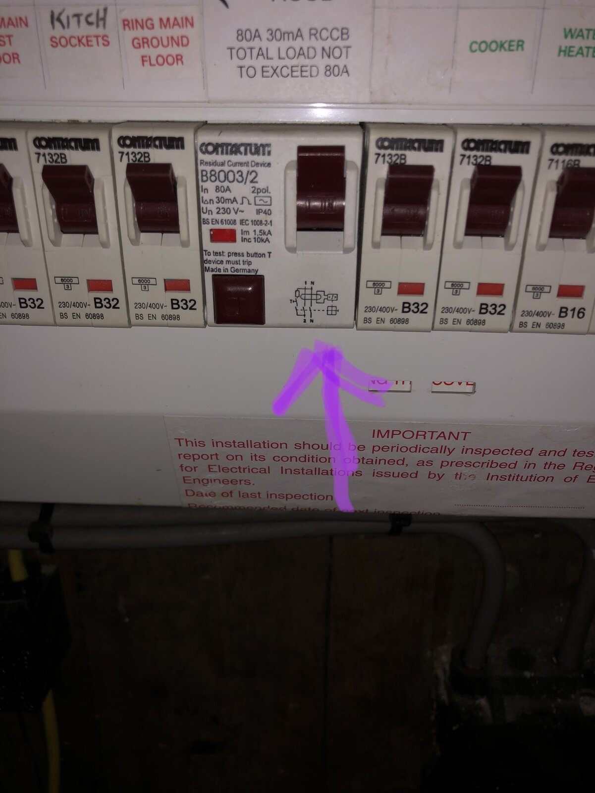

It’s the RCCB breaker that keeps tripping

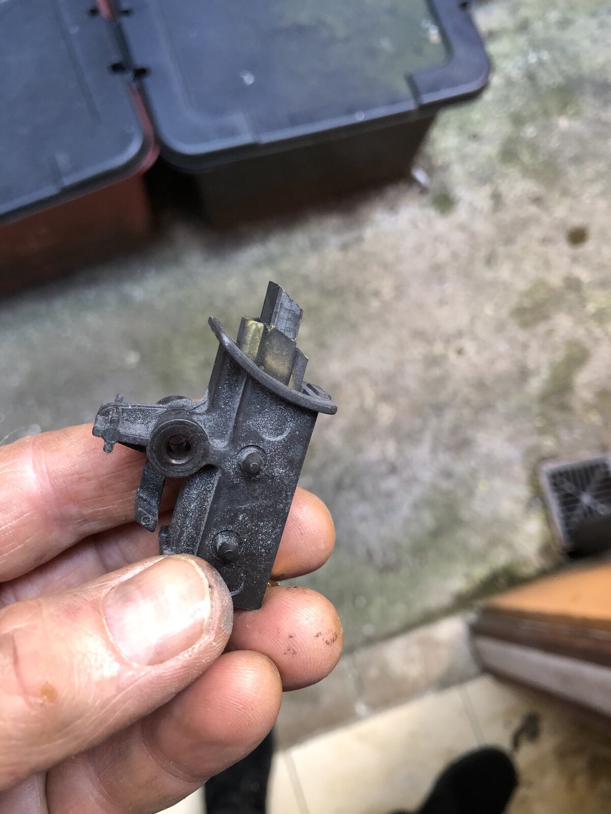

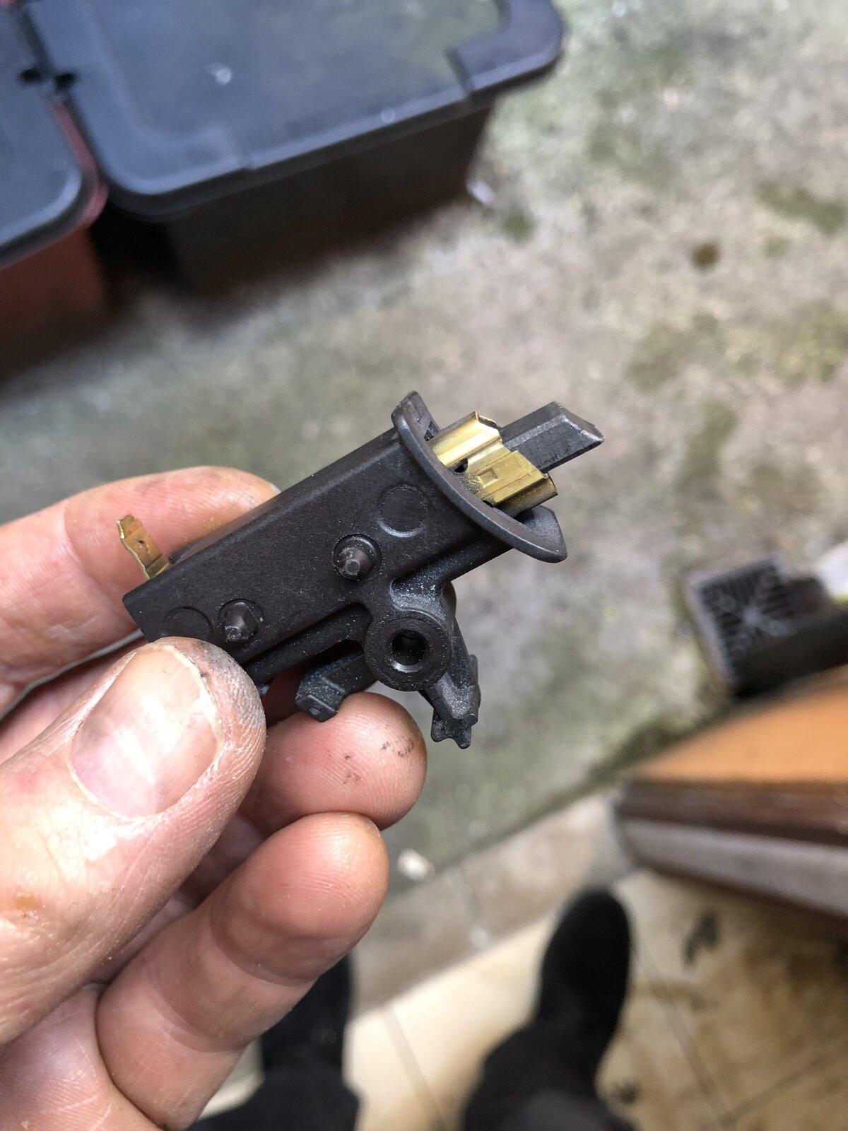

Did you take a pic of old brushes?
Would I be able to see that welded spot, is there anything that could be done or would the motor need replaced now? What about the shorting/buzzing has that damaged other parts now as well?
Pics
That suggests that there is an issue between the earth and live
Motor may have been damaged , when you get metal to metal or slight gap it can create a weld spot on motor ruining it .Buzzing may have been something shorting out .

I didn't take a photo of the worn down brushes. I didn't see the point, and whenever it happened (the sparks), I stopped using the tool.
Each of the tools were fine once I replaced the brushes. The commutator was fine in each case.

The fuse in the plug didn’t blow I just tested it.

I am not an electrician but, I cannot see why worn down brushes would cause a RCD to trip. For an RCD to trip, you need leakage between the earth and live.
