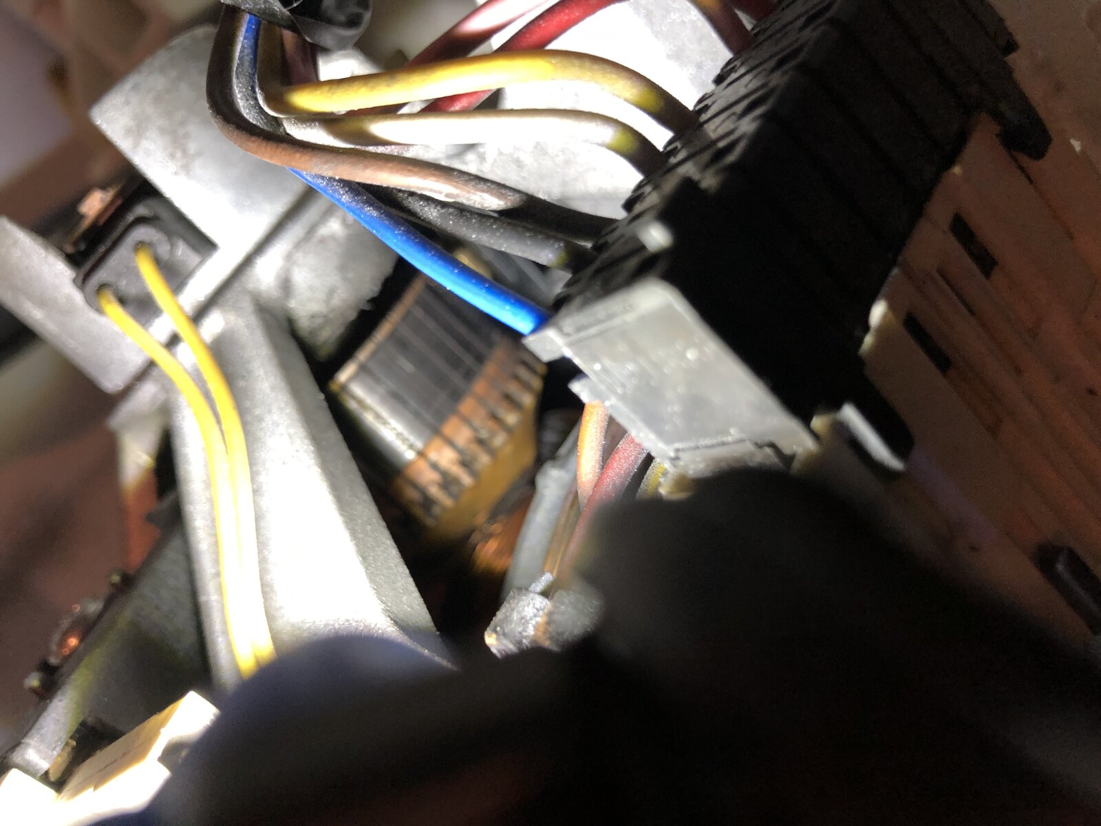

Edit- you have a lot of carbon build up on one of those two brushes. I am not an electrician, nor am I a washing machine repairer but it might be worthwhile checking the state of the commutator. To clean it, hold a green scouring pad against it and get someone to manually turn the drum.

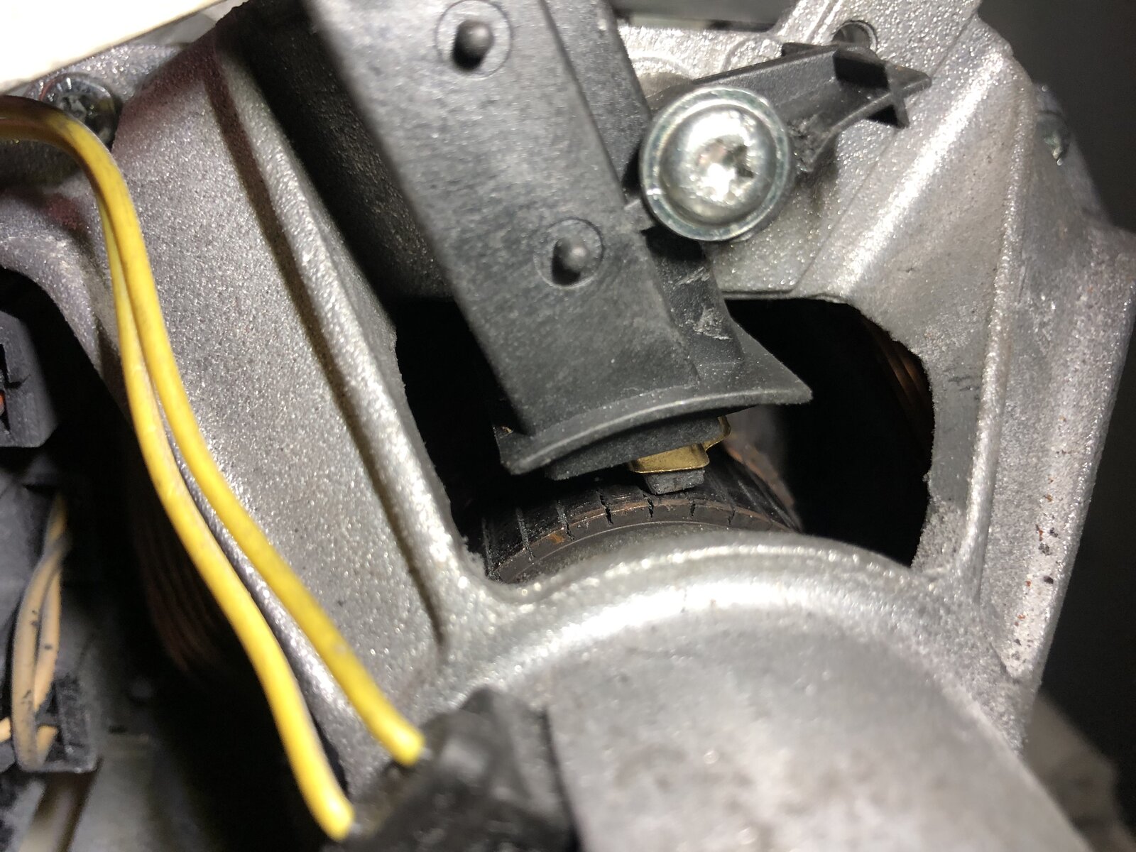

new brushes and stator photo

Your commutator is very dirty, but I am not qualified enough to say that it would be responsible, on it own, to make the buzzing noise.

That commutator looks to be in need of at the very least skimming.

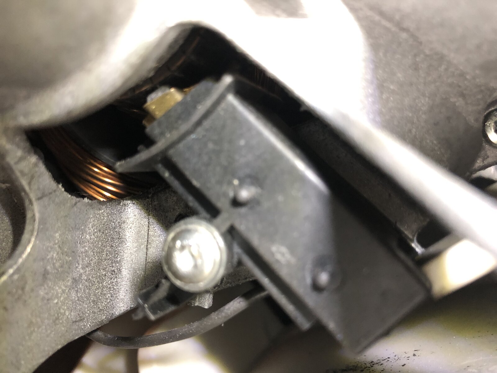

I also see that brush, in your second photo, is making contact with the comm, at a peculiar angle.. IMG_0247.jpeg
what wrong with the angle isn’t that the position it should be in? I replaced the brush from there in the same position. Would that cause the machine to not turn on and buzz then switch off?

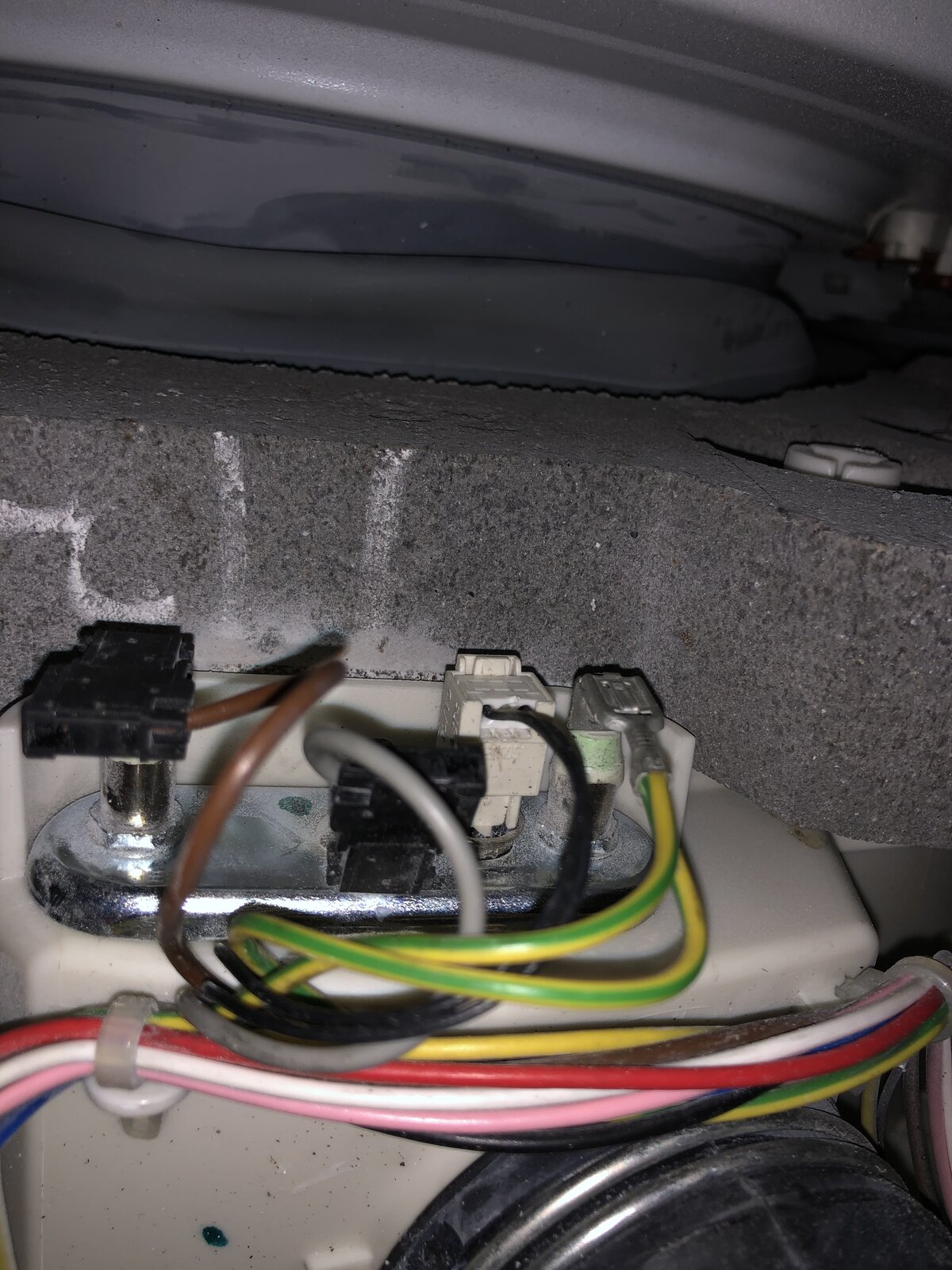

Heater element are the wires right? I forgot to take a picture before disconnecting but the way they were all sitting, bent into place, from being hooked up before was still present.
Ok without doing anything other than checking all the connections again and they were the same as before, the power is back on and I just got a small shock from touching the frame is that normal? Ok I selected a program ran it the pre wash water came on then the main wash water started but only ran for a few seconds then switched itself off via the stop button then began to drain the water from the tub, so it didn’t even fill for a main wash like it would before and didn’t even get to the point that the drum would start turning, and it drained itself out.
I'm only judging from a blurry photo, but the carbon of the brush tip, appears not to be a good match to the comm..
The entire face of a carbon brush, should be in full contact with the comm..
