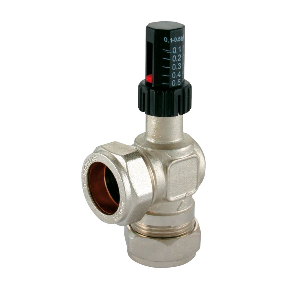

I am installing multi-zones on my central heating. I have a Vaillant Ecotec Pure 830...
I want to fit in an auto bypass valve in case the pump continues to work after my zone valves are closed. Which setting on the bypass valve do I need to set? It has the following setting: 0.1,0.2,0.3,0.4
ae235
I understand that I need to find my minimum flow requirement and pump curves, but I can't seem to find or work it out.
The boiler is the heat generator so the only item requiring a bypass. Check the installation manual for required bypass setting, be warned you usually need a decent length pipe run between boiler and bypass (so that the water circulating can cool down a bit, which is the whole point). 0.2 bar is a common setting.

A bypass is not intended as a stand-by, in case a motorized valve fails. Provided you buy a decent valve, e.g Honeywell (not an Asian look-a-like) you should get many years of life out of them.
Your boiler does have an internal bypass, but it's mainly there to regulate the pump output. (See the installation manual, which should have been left by the installer.)
An external auto-bypass only needs to operate when the boiler is running at minimum output, which is 6.3kW for the 830. The boiler is designed for a flow/return temperature difference of 20C. This is equivalent to a flow rate of 271 litres/hour. From the graph 30c on page 29 of the manual, this gives a pump head of 250mB which is the default setting.You have a large installation, so you may need to increase the internal bypass setting by turning the internal bypass clockwise, otherwise the ABV my never open.

Long as there are no valves on the towel rail- or is the rail plumbed before your (to my mind ill-advised) motorised valves, in which case plumb bypass across the towel rail & you'll need a lockshield on the towel rail turned down quite low so you get heat in the rest of the house.
Instead of connecting the bypass from flow to return, I can just connect it from flow before the valve to after?
No that will just by-pass the valve , the by-pass goes between the flow and reurn pipes before the MVs, or as you ask you can connect your towel rail before any MV and that will do the same thing
