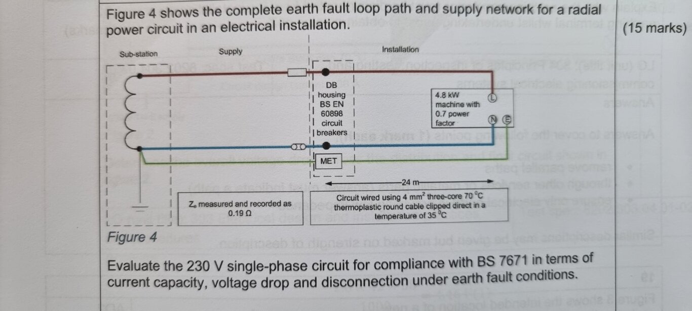

Just run through a past exam paper June 2022.
The last question is, as usual, a cable calc.
I was pretty close to the right answers on most of it. However two things threw me, when I checked the anwer sheet.
We've been taught that for a basic radial power circuit, You find the Ib (design current), select a protective device to get In. Then apply C factors for temp, thermal insulation, grouping etc etc. to get It. Then you look up the next size cable in the tables, taking into account installation reference method, etc. to get Iz.
In the answers sheet, their calcs take It and apply the Ca factor to it. This gives a different answer to mine.
I'm fairly sure I'm right and they are wrong but I'm only going on what we've been taught....
For more info, here's the question:
Their answer says to use a 32A breaker, then look up table 4D2A to find a suitable cable, they say 36A. Then they apply a Ca of 0.94 to get Iz of 33.84A
I think the correct answer is 32A breaker, apply 0.94 Ca factor to get 34.04A. Table F5(i) OSG shows Ref method C 2 core 36A capacity 4mm2.
The final result is not really much different but the calcs are not right.
Maybe the fact that the cable size is already identified in the question is the reason?
You're applying the ambient temperature correction factor to the wrong thing - you apply it to the CCC of the CABLE not the OPD. You just need to check that the corrected CCC of the cable is still >= the OPD rating.
The CCC of the cable is 36A method C @30C. You apply the ambient Ca correction of 0.94 to the 36A which gives you 33.84. This is > than the OPD rating so job's a goodun.

Hi Dave, the OSG says In is the overcurrent device rating and the factors, Ca Cg etc are applied ( In is divided by the factors ) and this gives a number It, the tabulated current capacity of the cable. You find the next value up from this to get Iz in the cable tables.
This is what the book says and what we were taught, but yes it does seem odd to apply factors to the rating of the breaker and not the cable!
The Regs book says same: "Divide the rated current of the protective device by any applicable rating factors" Appendix 4 section 5.1.1
Actually, reading on in the Regs Book, it also says that rating factors can be applied to the cable as multiplers instead but that requires some trial and error so the other method is more desirable.
So in the exam question answer, this is what they do. Multiply the cable capacity by the factor instead of dividing the protective device capacity by the factors!
Problem solved.
It threw me as we've not been told about this alternative method. It does make sense though.
IMO that's a bit backwards. It's the CCC of the cable that is reduced by a higher Ta, not the current rating of the OPD. Their reasoning is that you have to apply the correction for 3036 fuses that way so you might as well do them all that way. Who uses 3036 fuses these days?
As you suggest, I think they have done it the way they did because the OPD rating and cable size is given.
Note also that you are not being asked to design the circuit, but to check compliance of the given design.
I concede that the method in the appendix has the advantage if there are multiple correction factors in effect.
