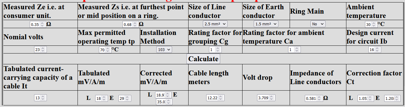

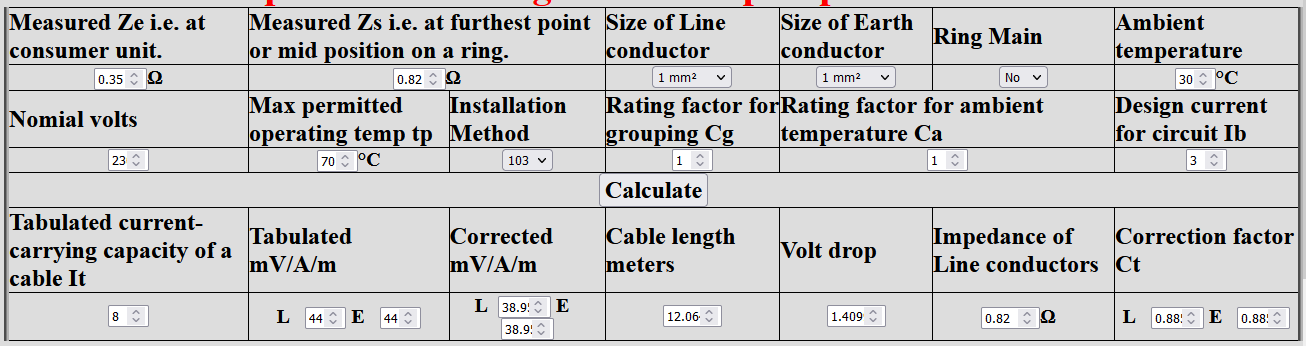

I have been doing some reading on this topic and would welcome your comment/validation of the scenarios below please:
1. Oven
Design current for this oven is 13 amp
Therefore closest breaker size but higher than 13 amps is 16 amp. I will be using a 16 amp MCB which is within the protection range of the RCD
Minimum cable size for this initially appears to be 2.5mm T&E based on reference method 103. However, when I look at the voltage drop calculations and tables, I think this requires a minimum of 4mm T&E. This seems to be adequate up to a length of 66 metres. I have a 12 metre distance.
That said, I think the cable rating needs to be higher than the breaker rating? So, perhaps it needs to be 6mm T&E?

Therefore closest breaker size but higher than 0.634783 amps is 3 amp. I think that's the lowest rating available? This is within the protection range of the RCD
Minimum cable size for this appears to be 1mm T&E based on reference method 103. I couldn't find anything in the voltage drop table for a 3 amp protective device. It starts at 6 amp. Why is that?

It seems 2.5 mm would do.
3.7 volt drop is well within limits.

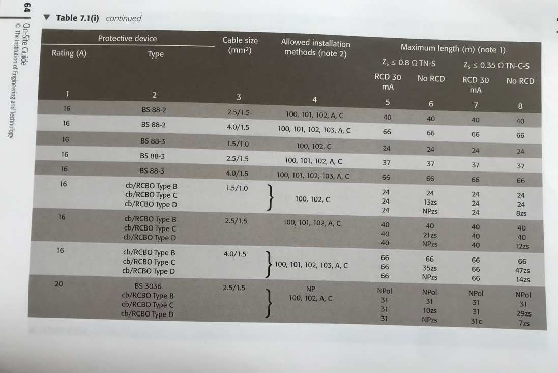

But in here, the only entry for method 103 with a 16 Amp breaker is for a 4mm cable.
Additionally, 2.5mm cable has a rating of 13.5 amps under reference method 103 and the breaker is rated at 16 amp. Does this not require the cable to be higher rated than the breaker?
