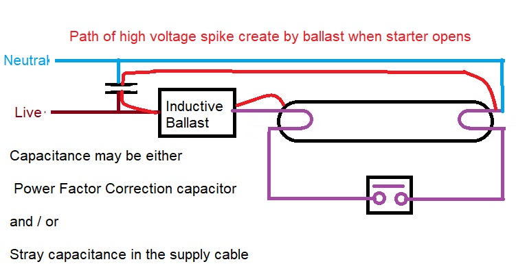

I really don't understand bernard's problem with winston's Variac.
The Variac affects / removes capacitive coupling that is part of the circuit for the high voltage spike that causes the tube to strike.
When the starter opens the magnetic field in the ballast collapses and this creates a high voltage spike across the ballast, This spike is the voltage that strike the tube.
The Variac will also create a spike when the starter opens (*), this spike might be in phase with the spike from the ballast ( improves striking ) or it might be anti-phase to the spike from the ballast in which case it will reduce the strike voltage across the ends of the tube.
(*) Some people may question this. The ignition coils in petrol engines create the voltage for the spark plugs when the contact breaker opens. Same with the inductive ballasts in fluorescent lighting units
I need to think about this, but I'm not sure that I'm convinced by what you suggest. You seem to be implying that if there were no 'PF Correction Capacitor' (which would have a 'functional purpose' beyond just PF correction) and if the path to the power source was very short ()e.g. as I suggested, a nearby 1:1 transformer), hence minimal L-N 'stray capacitance', that the light would then not work. Is that your belief?
Kind Regards, John
