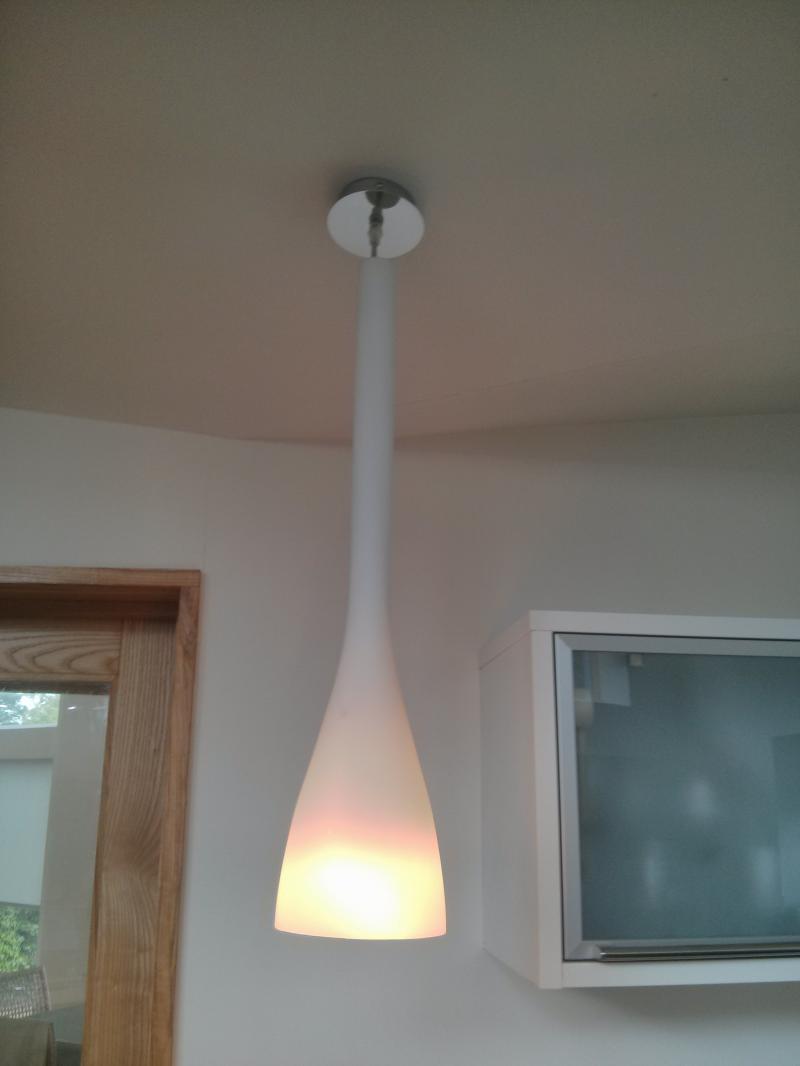

I have a couple of long glass hanging lights in the Kitchen over the breakfast bar, which were fitted a couple of years ago when the house was built.

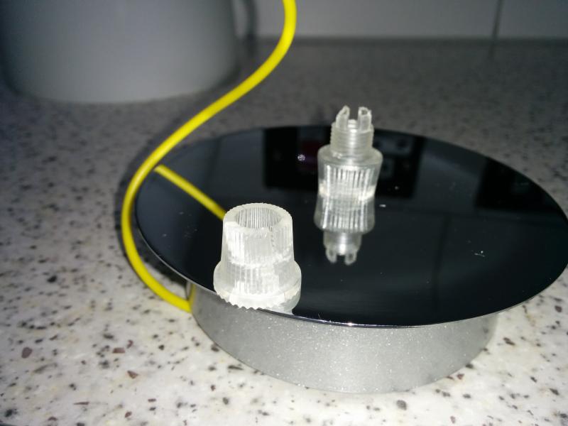

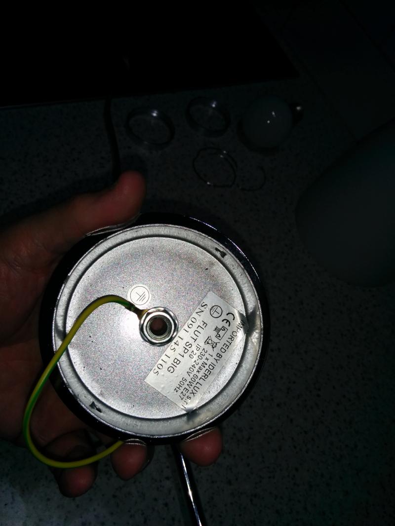

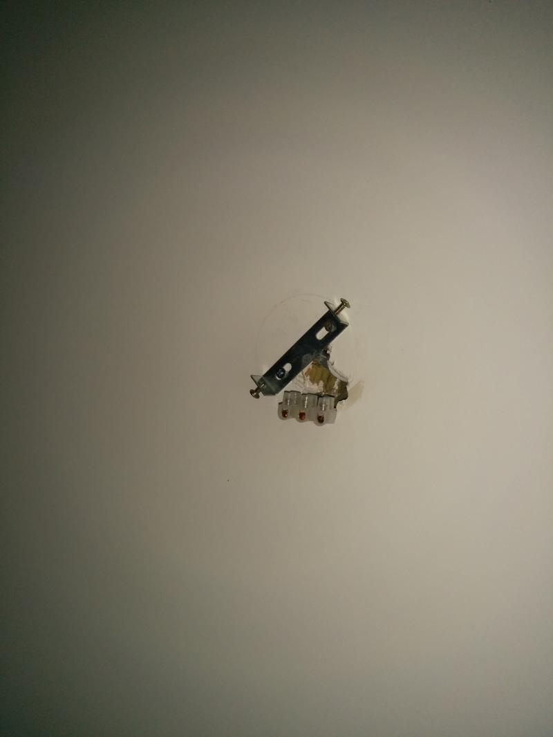

One of the lamps dropped several inches and when I investigated I found that the weight of the lamp was help by a clear plastic friction nut which screws into the metal ceiling rose that is then held by 2 screws onto a plate fixed to the ceiling. However the plastic cable clamp has cracked and is no longer holding the cable which then slipped down and all the weight was being held by the cables screwed into the the connector strip from the ceiling.
This seems like a very poor design (although the light cost several hundred pounds).
Trouble is I don't know what I need to buy to repair it but I think I need some sort of cable clamp that can go inside the metal rose so that the wight is held by the metal rose and ceiling plate rather than just on a weak brittle cable clamp.
Grateful for some advice on what I need and what its called.
For now I have disconnected the fitting completely by removing the fitting wires from the connector block on the ceiling.

From your description I suspect the "friction nut" is manufacturer specfic, you might be able to get a spare from the manufacturer but failing that you will probablly need to replace the whole ceiling rose.
You could get one of the dome topped lids for a conduit box and screw a compression gland into it but the result may look a bit industrial. You might also be able to find a suitable replacement rose at http://www.urbancottageindustries.com/historic-lighting/lighting-accessories
Years ago a friend had a similar problem. Too much weight on cable and cable clamping. In the interests of safety we used a chain to take the weight of the lamp with a hook secured to the joist and thinner cable threaded through the links of the chain
Sometimes a cable tie round the flex above the ceiling plate is sufficient
... or, not that I would advocate it, I've seen a 'knot' in the flex used for the same purpose. I've also seen plastic collars with securing plastic grub screws put around the cable in a similar fashion.

Hi All thanks for ideas here are a couple of photos of the fitting and lamp:
Thanks. We've all been concentrating on the cable restraint issue at the top (in the rose), but what happens at the bottom of the flex (since the entire weight of the glass is being taken by the cable)? Is there some proper restraint down there - or is it again, all hanging off the electrical connections?

Thanks everyone problem now resolved, I went to the supplier that I got the light from and they provided a new taper cord grip and in addition I added a cable tie inside the rose.

Hi John, I did check but at the bottom the fixing is pretty substantial, the lamp holder fits on the end of a metal tube and the tube holds the weight of the glass shade via a number of smaller spacer rods at the top and bottom so there is no stress on the lamp holder at all.
The whole lamps hangs on the cable which is now clamped using the replacement taper cord grip but with the additional cable tie proving additional support from above. So basically its a little bit safer that the original ...
