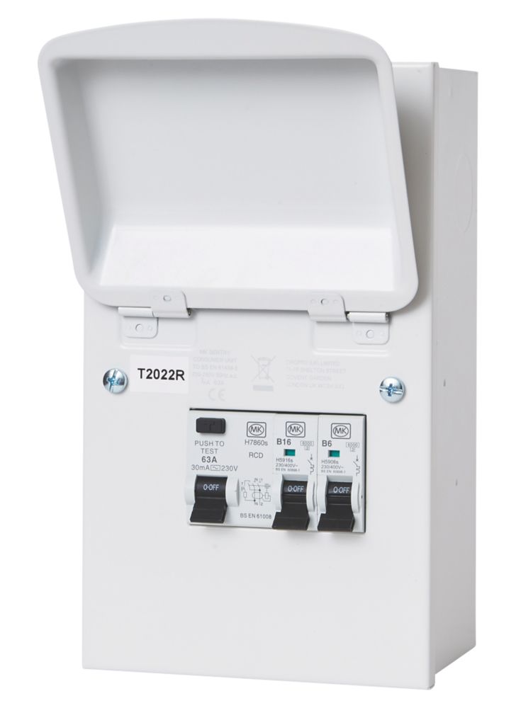

I’ve seen some garage CU’s that only have an RCD (and some MCB’s). There’s no main switch.
In that situation, the RCD is ostensibly the main switch?
If it disconnects the line and neutral of the incoming supply then it is the main switch for the garage circuits.
Can I check if that's what Garage CU do? I thought they did...
Here's an example of the sort of thing I was thinking of:
It is - and, for that reason, I think that all RCDs (RCCBs!) are designed to have adequate contact separation when open (etc.) fair them to qualify as devices acceptable for isolation, per BS7671.
Kind Regards, John
As TTC said, yes. Some people call the device at the upstream end of a CU the "Incomer", whether it is just a 'Main Switch' or an RCD (RCCB, incorporating DP switching).
