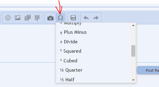

works² for² me² but I think I find the Ω method easier.
Did you type the numbers on your machine's numeric keypad?
As you say, in this forum it's easier to just use the drop-down symbols list, but the ALT-sequences can be used in all sorts of places (like word processors).
Kind Regards, John
Kind Regards, John
They were all done with keypad entry but it feels easier to use the drop down menu, especially as it leaves it on the 'last page'.
Yes, that's a useful and clever (and quite unusual) feature of that drop-down - given that, in any one post I write, it's usual that most of the symbols I use are the same (usually all ² or all Ω).

Now knowing where characters such as 'degrees °' etc etc is very helpful.
