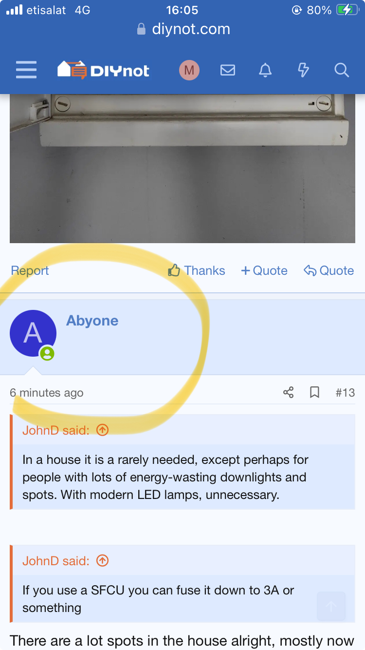

This is what I see
There are a lot spots in the house alright, mostly now with LED bulbs but house was built 20years ago.
There is already a standard light switch installed inside for the lights, I was just planning to connect the lights.
