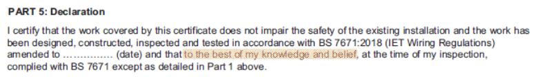

Obviously I am a bit skeptical at this point. Is there a way to verify that the MWC is legitimate?
What do you mean by legitimate? I suppose the answer is "NO".
It is just a piece of paper with some statements and test results written by the person who did it.
Literally (correct meaning) anyone may (is allowed to) do it.
Really......this is the advice you give to people who want to play at being a sparks........Have a word
Must be a competent person
Even an 'incompetent' person could complete an MWC (quite possibly "correct to the best of their [limited!] knowledge and belief"!), although it would be pretty meaningless.
I'm not sure what "legitimate" would mean in relation to an MWC.
Kind Regards, John
That's really all about the scope of a "MEIWC" (i.e. what works it is appropriate for) rather than offering any opinion as to who 'may' or 'should' (anyone 'can'!!) complete one.
Kind Regards, John
So... in the end the builder has agreed to call an electrician that, in theory, would have just signed the certificate. In practice, he has spend ~2h in the loft and basically has re-done the whole thing.
