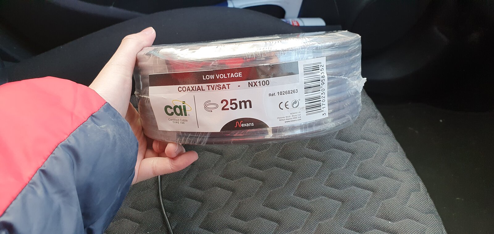

So does that mean you can CUT the NX100?
I didn't realise that, I thought I had to use the full 25m LOL, that's why I was put off,
LMAO at the things we take for granted, such as presuming someone understands that a reel of cable is there to be cut to length. :ROFLMAO::ROFLMAO::ROFLMAO:
Life lesson 101.... Never assume anything.
To me it was akin to cutting a HDMI cable to length, which is why I didn't think about cutting it!
Didn't realise it is I guess more of a raw cable which you can cut.
Thanks!
Well, now you know. Something with bare ends - that means no plugs fitted - usually denotes that its cable to be cut to length.

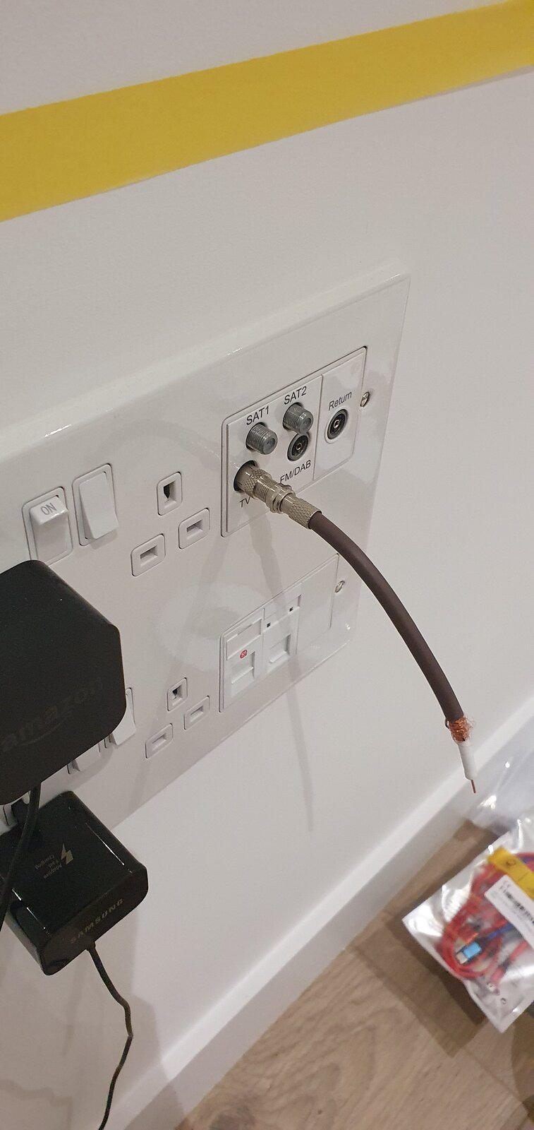

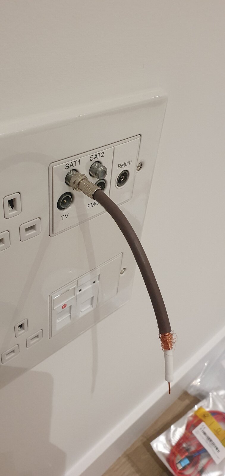

So I've managed to cut them and (test) connect them to the wall, please see attached images.
So for TV it goes: Coax Cable > F Connector > F Connector adaptor to female > Wall
And for Sat: Coax Cable > F Connector > Wall
1) For the "TV" connection, it is really chunky. I will have a TV stand, so I can't really have all this length poking out. Can we shorten this somehow? Is there an F connector that goes straight to female? I was thinking of having one of these L-shaped ones:
https://www.amazon.co.uk/Coaxial-Ae...jbGlja1JlZGlyZWN0JmRvTm90TG9nQ2xpY2s9dHJ1ZQ==
But they don't female to female? All of them are male to female, in which case I would need to add ANOTHER adaptor?
Why do they have a male "TV" on the wall? It just seems inconvenient. Is the "Return" female port on the wall TV also, can I use this one instead?
2) For Sat, it seems good. I think I might buy the right angled-one to save space.

the "return" socket is intended to be used to feed the second output of a sky box to other parts of the house. do we assume that the short bits of coax are just you getting used to fitting f connectors? if you want right angle adaptors from f conn to male/female "tv" plugs the e-bay is much better than amazon ie

Oh I see,
Yes haha, this is just me practicing the cutting and connections on a small piece of cable.
Oh nice, I think one of those female to female right angles will be much cleaner for me!
By the way, does connecting many adaptors together cause a reduction in quality? As I will be using about 2 adaptors in the TV connection!
Thanks,
The wall socket has a male because the female socket as fitted to your TV is an IN, and so the opposite of an IN is an OUT, and the opposite of a female IN is a male OUT.
Its been this way for years,certainly as far back as the days of VHS and Betamax VCRs. You never really noticed because the leads supplied in the VCR box for the connection to the TV were female to male. That, or they came with a gender changer adapter.
Coming back to your cabling, all these adapters and plug ends are just making a simple TV coax job much harder than it has to be.
For the wall side you need a female coax plug. For the TV end its a male. That's it, unless you want to get fancy with right-angle connectors. I wouldn't bother though as the lead at the wall will have as compact an end as the sat cable. At the TV end, the lead often plugs in so the cable tail runs parallel with the screen surface rather than sticking out perpendicular.
