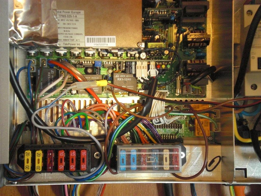

The habitation controls today get rather complex 1687769047727.png I know it took me some time to work out what the one in my caravan did, one shown is from a motor home. I know mine caused a problem with the new radio, as every time one plugged in the car, supply to radio was lost for a few seconds, which would cause the radio to switch on in demo mode. Had to swap fuse supplying radio to one live at all times.
But there are so many systems, one simply can't cover all the options one might find, and as an auto electrician back in the late 60's early 70's I still spent a few hours working out what the bank of 5 relays in the caravan were designed to do, and I would stand no chance of working it out remotely.

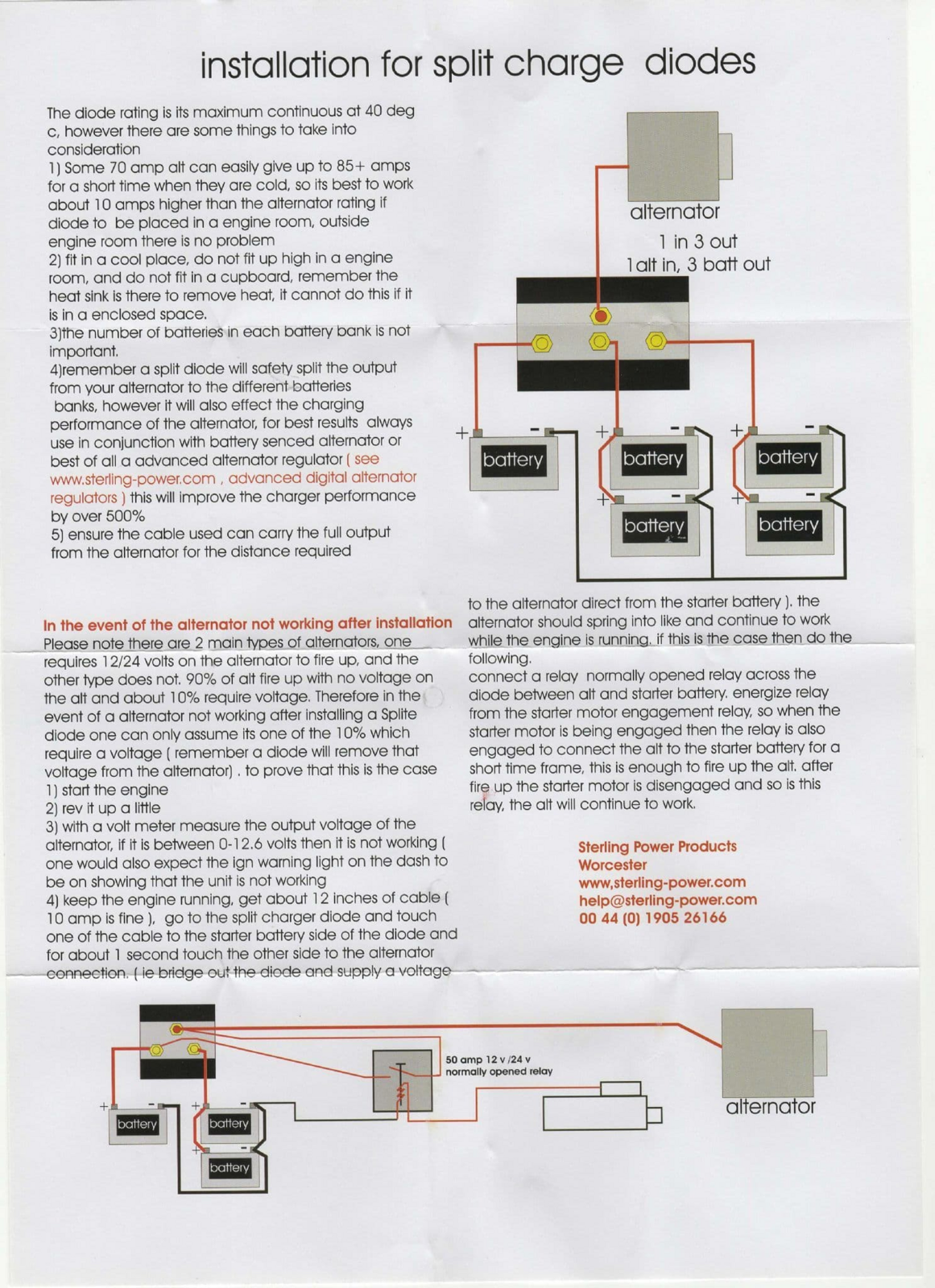

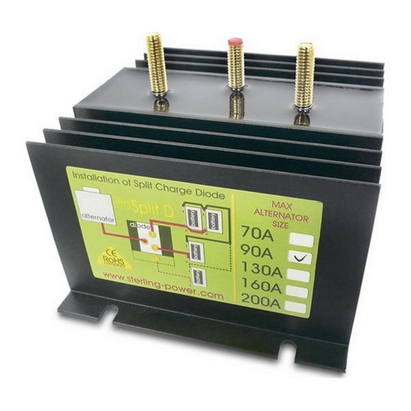

Back in early 70's we had blocking diodes and split charge relays, in theroy the blocking diode was best option, but in practice the 0.6 volt drop across the diode slowed down the charging, so the relay worked better, often double contacts one for fridge direct, and other to charge leisure battery, the BS 7671:2008 stipulated how the two supplies should be used, and to comply some sort of relay in the caravan was required, with a motor caravan not limited to 13 wires, so there are other methods available. But at 13.8 volt typical for most vehicles, the charge rate was very low, using an ammeter I would see maybe 30 amp for first few minutes after starting engine, but then it would drop to around 3 amp, with narrow boats with same system cruising all day (8 hours) was not enough to recharge the batteries, and with caravans and motor homes the engine likely runs for a much shorter time.
But you wouldn't just add diode into the charging circuit and expect it to continue charging correctly would you?

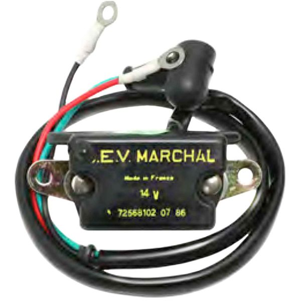

That was the standard Lucas CAV method. With the CAV regulator you had a Hi, Med, Low setting, but nothing with the Lucas, the new version 1687785194687.pnguses a different type of diode. And I would with old Lucas alternators replace the three phase diode pack with a Durite one where the diodes for the excitation were same size as those to battery, and add a new set of three diodes for the excitation so alternator had two outputs. But as standard nothing. Today there are some replacement regulators 1687785604692.pngdesigned to turn alternator in to a stage charging unit. But here is a copy of the instructions
As you can see nothing to lift voltage to compensate for drop across diodes.

That was the standard Lucas CAV method. With the CAV regulator you had a Hi, Med, Low setting, but nothing with the Lucas, the new version View attachment 306785uses a different type of diode. And I would with old Lucas alternators replace the three phase diode pack with a Durite one where the diodes for the excitation were same size as those to battery, and add a new set of three diodes for the excitation so alternator had two outputs. But as standard nothing. Today there are some replacement regulators View attachment 306786designed to turn alternator in to a stage charging unit. But here is a copy of the instructions
