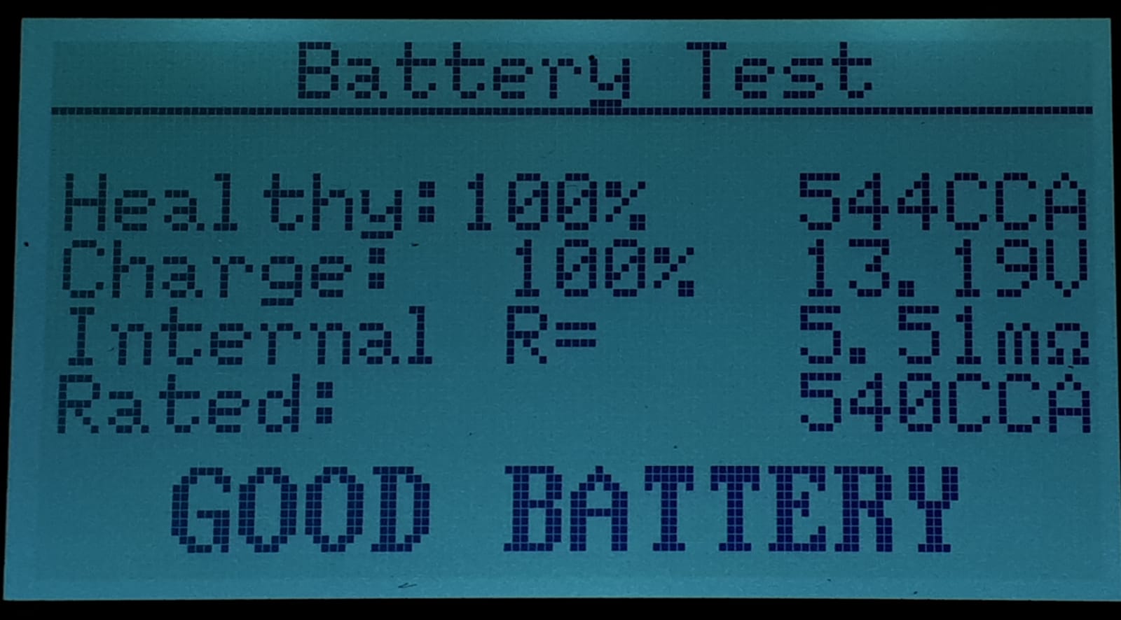

Have just been speaking to the garage which diagnosed a "cooked" battery along with a failed alternator on my daughters car.
After they replaced those two items, I got the old battery back: it was at 8V, but took a good charge and is still well above 13V a few days later.
The garage said they had tested the battery while flat and found it needed to be replaced.
Is there really such a battery tester? - ie one which can test a totally flat battery?
UPDATE
Today I've tested the battery (fully charged about 3 days ago) with a TOPDON BT100 Battery Tester. It says it is good.
I've also tried the tester on an old discarded battery which was at 1.5V . It wouldn't work until I'd got the battery up to several volts at which point it asked for the battery to be charged and retested (after which it said 1% health, 83mΩ & REPLACE)
I would not have expected the battery to be bad after being flat (for the first time in its short life) for 3 days, but am surprised it tests so well after being left uncharged for another 10 days on top of that.
The battery is a DriveTec from GSF.
My post was not to determine the condition of the battery but as per title. I'm adding the results of this further test due to the interest shown in the condition of the condemned battery.
