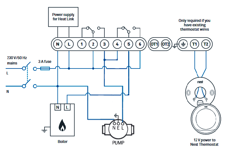

I use Nest not Hive, but also have a C plan boiler, since Nest has volt free change over contacts the wiring is very different, Com goes to boiler with Nest with no tank thermostat, and it can be configured to run with a tank thermostat.
But Hive uses internal programming so one output to pump, other output to boiler, and it runs both for central heating and only boiler for DHW.

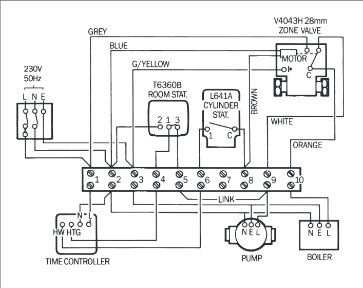

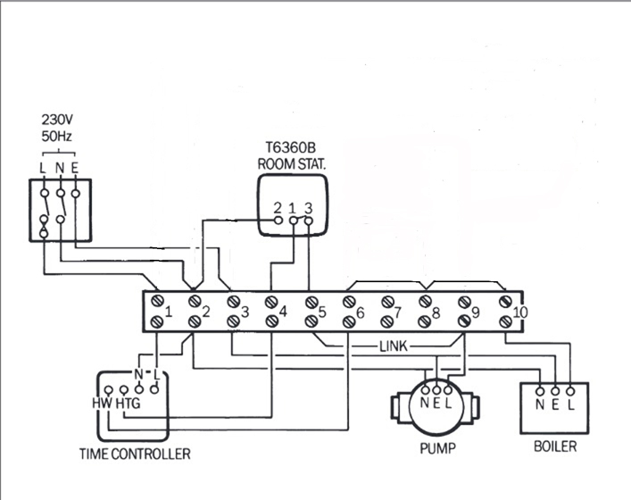

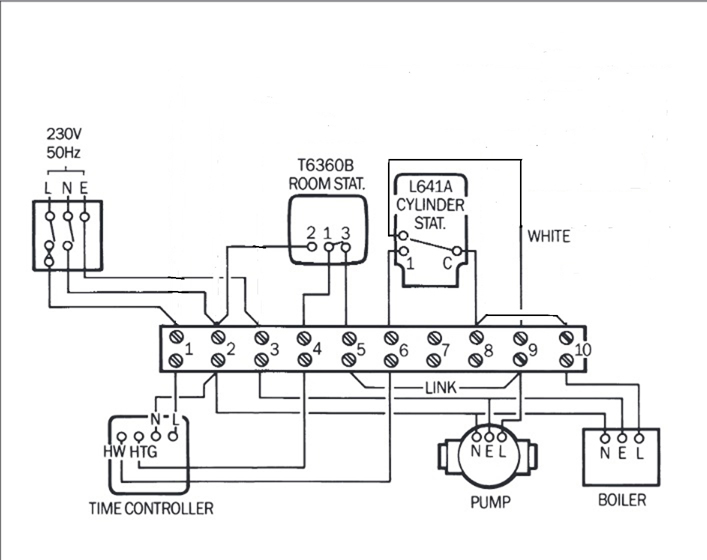

The C Plan comes in three flavours, and over the years a tank thermostat has often been added so in summer it only runs boiler when required, and some times even a motorised valve on the DHW so the DHW temperature can be reduced to that used for central heating.
I have the basic design, and one advantage of Nest is in summer only heats DHW for 20 minutes 4 times a week, actually set to ½ hour, but boiler cuts out after 20 minutes, which is a great improvement from the old programmer which did not have a weekly program so heated water for at least an hour a day, well it would clearly turn boiler off as water heated up, but all pipe work also gets hot, so greater waste.
So basic C-Plan_old2.jpg with thermostat on tank C-Plan_old.jpg with motorised valve C-Plan.jpg and wired for Nest C-Plan_basic_Nest.jpg I in error for a long time thought Hive could not be used with C Plan, then I read how it was a software fix, I have looked for a Hive C Plan basic wiring diagram but can't find one, and wonder if the option has been removed? All I can find is
