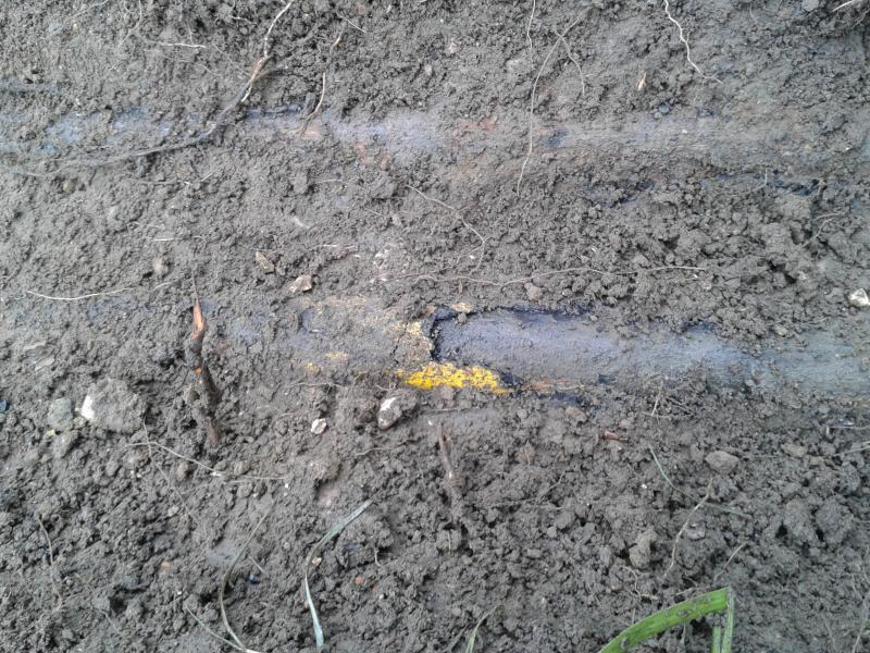

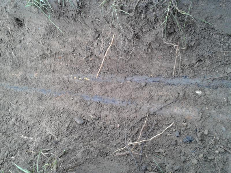

Can anybody identify these 1.5" 'buried' pipes? Photo.
It was a good idea. Any big screwdriver against your ear will do. I can hear my water meter ticking over without a stick.
I can't believe I'm gonna go out there and 'listen' to these pipes with a 'big screwdriver to my ears'....the neighbours will be wetting themselves!
A broomstick or similar piece of wood will do. It's just something solid that will transmit mechanical vibrations (ie noise) so you don't have to put your head down the hole to get your ear against the pipe - which would have your neighbours rolling around in hysterics.
That's how we used to find 'tappet' noise in overhead valve engines.
Update: I've just been out there trying to dig a bit further to expose these pipes.
I'm starting to think they're gas pipes....from the photos you can see a bit of yellow on the outside of the pipes which crumbles away when I touch it (I think I remember reading somewhere that gas pipes are yellow colour coded?). Also, (if you squint a bit and know where to look) you can just about make out two connections along the length of these pipes as somebody previously mentioned. In addition, I can't hear any vibrations when I listen to these pipes.
Still not sure if they are 'live' as, even though they're in line with the gas meter, the inlet/feed to the gas meter comes in from a right angle a meter or so away?
Think I might start digging from the inlet to the gas pipe so see where that goes.
Does the "gas company" (whatever they are called these days) have a service where you can call them and ask "Are these gas pipes ? And are they 'live' ?"
Well, I did ring National Grid last week when I found these pipes. They COULDN'T confirm if these were live or even if they were gas! They could only tell me where the closest underground gas mains/junction was but couldn't tell me how the service pipes were routed from there to my meter!
They also said that if I wanted the re-routed I would have to pay for that (including, digging up pavement/road etc etc).
HOWEVER, it was my understanding that if I damaged these pipes (and they were indeed live and gas) then they would repair them at their cost since they're not sufficiently buried to start with!
Now that I have more confidence that they are indeed gas pipes (yellow in colour with connections every so often), I'll ring them to see if they can send somebody out to 'bury' them a bit better as sooner or later they will be damaged - I'll also ask, if they will do this at their cost. (Hoever, I have a bad feeling that they'll only cover the cost of the pipes are damaged).
