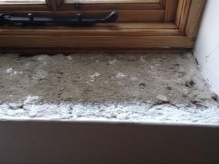

I have five slate tiles to use on my kitchen window sill. Someone recommended that I just use cement to fix them seeing as it is not a floor and will not see heave traffic.
I wondered if anyone here can confirm whether that's a good idea or not?
Also, if it is OK to use cement, what's the minimum thickness I can get away with? The thinner the better for me....
See photos below for how the window sill is at the moment with the old tiles removed.

They'll be more likely to stay put if you use a cement-based floor tile adhesive.

Sticking me nose in, but I've had success with the Wickes rapid set ready mixed cement compound.......it mixes really smooth, indicating an added plasticiser. I got rid of any loose stuff, gave it a coat of PVA and set to.
It worked well, and was available in 2kg bags, I think.
John :)
That's the sort of stuff Max and if you check out 220997 that's the very product I used.
My job was tiles onto thermalite......I dampened the blocks well, brushed on a PVA layer (a squeeze of wood glue and a wet paintbrush to be exact) and got cracking.....the tiles haven't shifted.
I guess the secret is not to allow the surface you are tiling on to become absorbent to the extent that it absorbs too much moisture from the cement mix.
All I can say is that it worked fine for me!
John :)

Can anyone recommend a cheap primer to use? I only need a really small quantity - enough for 5 tiles. And money really is too tight to mention (as the old song goes).
As for adhesive, I'm planning on using Burnerman's suggestion:
http://www.wickes.co.uk/Wickes-Quick-Set-Mortar-2kg/p/220997
Do I definitely need a primer if using this? The window sill had tiles on it before that we removed, just in case that makes any difference.
Cheers
That primer will work well, Max.....there's a fair chance you won't need it, but better do it anyway.....you don't want to do the job twice!
