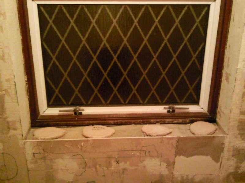

Originally in place was dot-dab fixed plasterboard covered in tiles, but when I took the tiles off of it, the whole board crumbled, I'm guessing due to both damp and age, (the tiles had been grouted to window frame, and grouted at the front edge with the overlap the wrong way too!)
This is what I have left at the moment:
I've already bought the 12.5mm plasterboard to replace the old stuff with, but then figured that I might look at getting a proper sill instead. I had no idea of cost, so thought I might as well look into it :)
The window is getting changed next week, so unlikely to do anything with it before then anyway.
Dimensions are 175mm from EXISTING window frame to the front face of the plasterboard covered wall below, and 1095mm wide.
As I say it used to have 12.5mm plasterboard, plus tile, plus adhesive so perhaps a total thickness of 20mm. I guess I could go for 30mm IF I needed to, but I'd have to chop down the plaster 'dabs' and also trim down the height of the front plasterboard too.

well you have suggested a stone mason,i have just gave the OP an other option he could look into.
yes, I understand and your method would work fine also but would look exactly how it is made, like someone has plonked a tile onto the window sill, acceptible but a compromise

Schmill, as you said, get the window in first then see what you are left with, in an ideal world the window frame should be equal on all sides. I would be looking at dot and dabbing a new piece of p/board straight onto the blocks then covering it with whatever you decide, whether it be a tile or a piece of granite, marble or whatever, it can be done last thing after the rest of the room is tiled.

Thanks, I wasn't sure where to replace the plasterboard, and then put a sill over the top of that, or whether to remove (ie. keep off!) the plasterboard on that section and just fit some kind of sill straight on.
