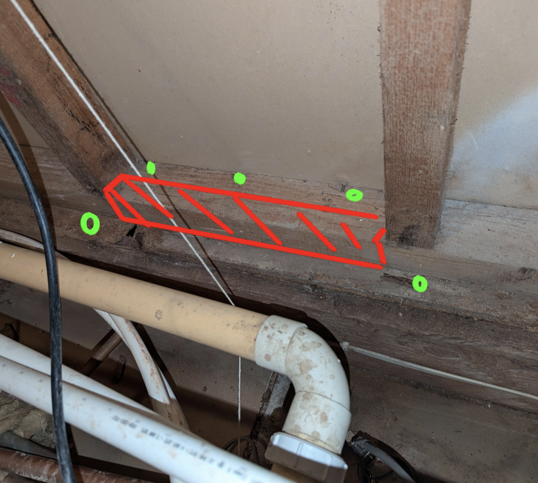

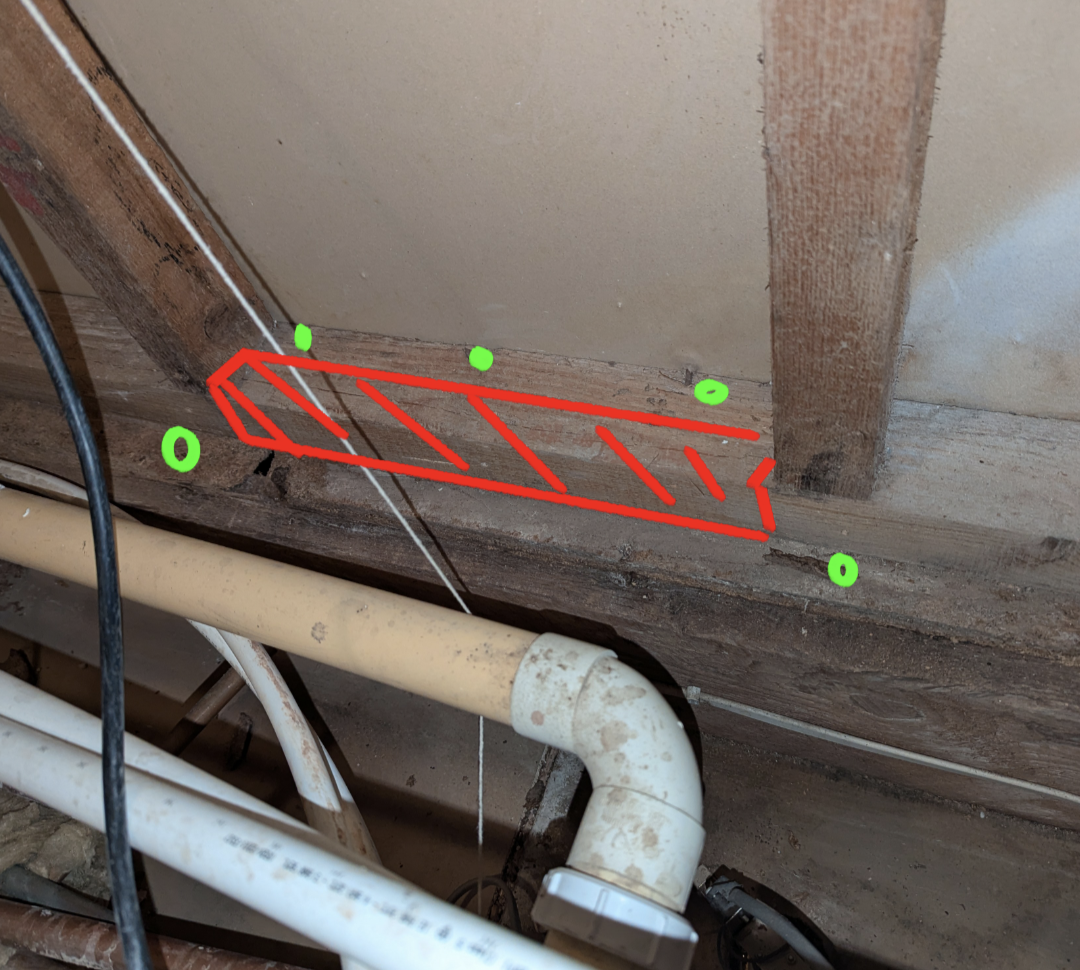

AHH I see, you mean cut out the red hatched section and screw roughly at the green dots?
The studs are only about 700mm so will only provide a 350mm space to work with. If not enough, I may cut the whole thing and add a noggin above to help with support.
I don't have reciprocating saw, I wonder if multitool will handle this cut

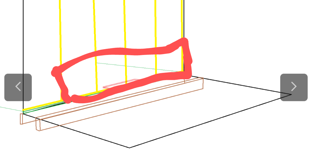

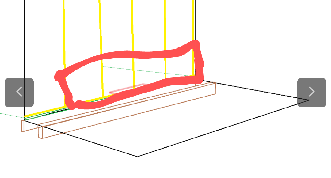

Can't quite figure this out, presumably the issue is you can't access the next joist across to fix a support for the floor plate? You could fix a strip of 18mm ply or OSB across the bottom of the wall to bridge the weak area, either all the way across or just behind the bath - a basic "I" beam.

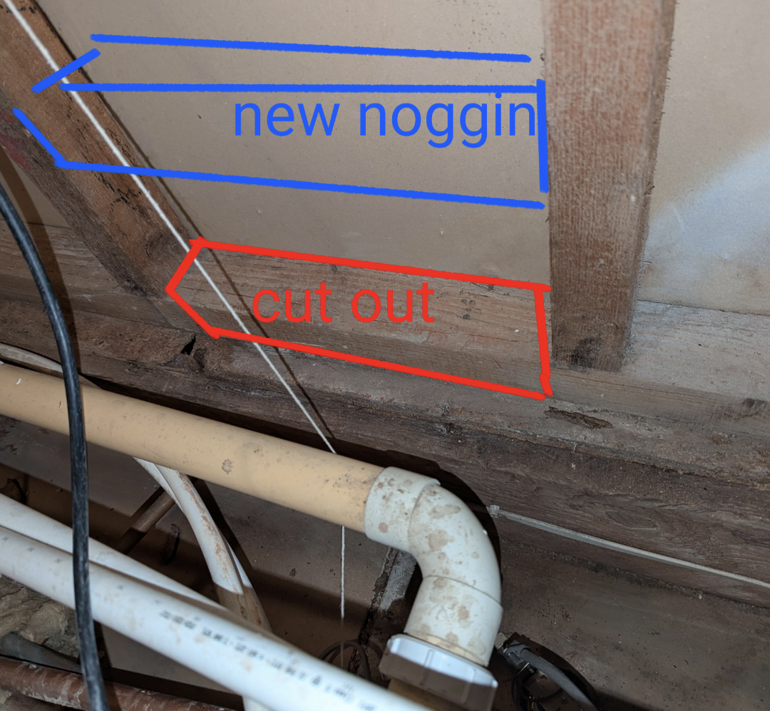

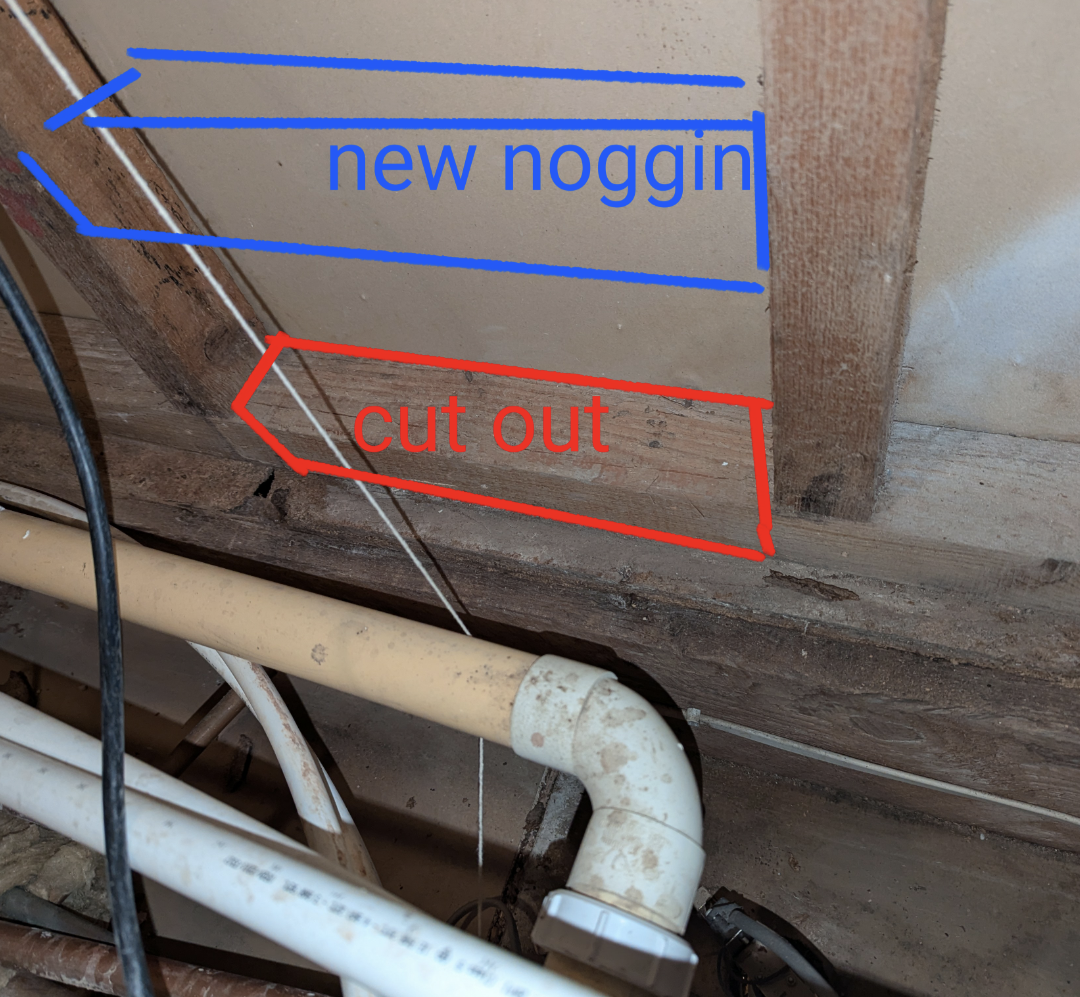

Yes, that's right. I did wonder earlier whether it would be safe to cut out a section of the floor plate and add a nogging above to support the vertical studs.
That way, I can cut out more of the chipboard and hopefully can slide a smallish beam through the cut out section and help support the subfloor in the bedroom side of the joist.
