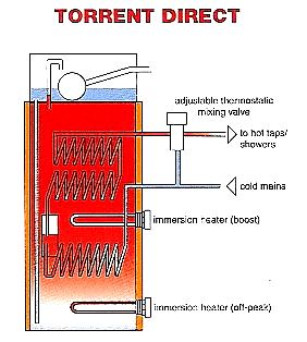

Doitall's last was correct, you can use a thermal store for DHW only, and supply the rads from the boiler with weather comp.
Weather compensation varies the flow temperature to the radiators inversely with outside temperature. If you put a Y Plan on the central heating side of a combi, the flow temperature has to be set permanently high so as to heat the connected cylinder. Therefore you can't weather comp it.

If, say, you draw hot water at 45°C through a thermostatic mixing valve, what is the minimum temperature the thermal store can be set to? Would that work with weather compensation?

Yup, silly money for thermal store - not even a pressure vessel. Build up the lagging around the cold tank and run just shower direct from combi (9 litre/min from 27kW is better than 60A electric shower or non-pumped shower from vented cylinder). As you say, pumped shower from vented tank if you don't mind expense, noise, water meter and shortish showers. Some members of my family can stay under the shower for 40 minutes, but then I have an upgraded water feed, 2x25kW system boilers and a 300 litre unvented cylinder restricted to 13 litre/min by the shower head.

Thanks to all who have posted constructive suggestions. I like the thermal store idea.
I'm not overly concerned about the cost. As long as the system is efficient and works well I don't mind paying a bit extra for it.
In a ideal world, if I knew a combi would never break down I would go for one without hesitation. The boiler we had in our last house was great!
We now have a baby and ever being without hot water is not an option. The thermal store seems to be the ideal backup solution for our needs.
