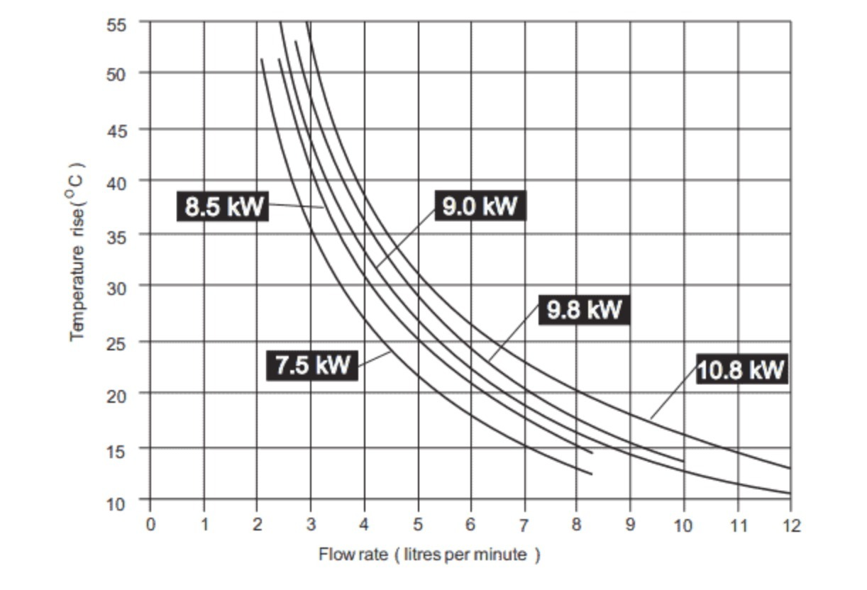

6MM2 cable will supply a 9.0kw shower so assuming a "average" showering temperature requirement of 40C, a 9.0kw shower will supply a flowrate of 3.8LPM from cold water supply of 6C in the very debths of winter, a more realistic cold mains of 10C will give result in a flowrate of 4.3LMM at 40C and at 15C will result in 5.2LPM.

On the flow rates, I found the image below which aligns with your calculations. I am hoping that (aside from the pump) I should at least also get some benefit from the cold water tank (which is located in the spare room cupboard) being a little warmer than the incoming mains - especially during winter.
