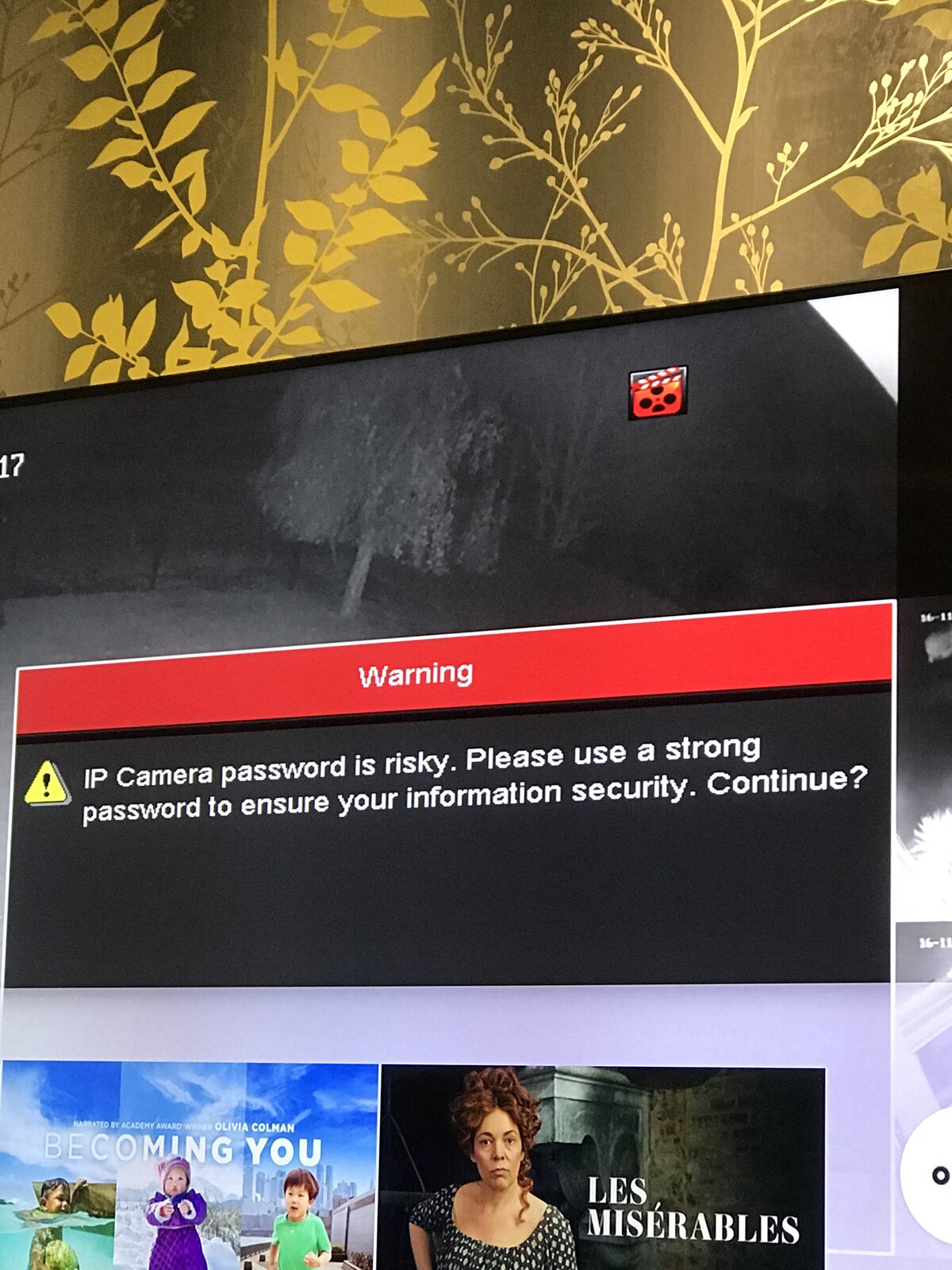

I have a Hikvision NVR system. This is connected to my living room TV via a HDMI cable.
This is the display on my TV:
I can connect to my system via the internet and my mobile app. I don’t have a monitor connected directly to the NVR.
Can this message be removed without a directly connected monitor?
Also, my password has uppercase, lowercase and numeric characters. Would you know why the system is reporting this?
Thanks in advance.

The passwords don't meet the secure criteria.

the system looks at the password and thinks it isnt good enough, all the passwords we always meet the standards the system requires.
You are probably looking for turning off passwords or poor password notifcations in the exceptions menu. Dont have a version 3 firmware unit in front of me to confirm.
but its the same place you would turn off beeping for hdd fault/ hdd missing.
Surely, you mean your NVR system password has uppercase/lower/numbers though, the one you login in with normally?
That error message is specifically talking about the IP Camera's password, which you should have changed the day you set it up. I bet it is still set as "password" or something equally bad?
