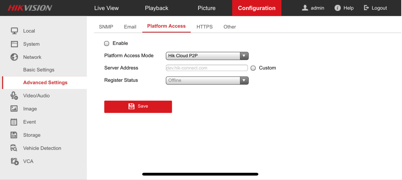

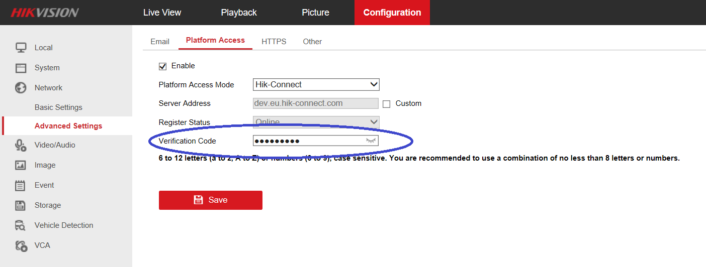

The verification code is on the bottom of the NVR sticker. Or depending if you have enabled it go to browser then login -> configuration -> advanced settings -> platform access

Sorry missed a step - configuration -> network -> advanced settings -> platform access

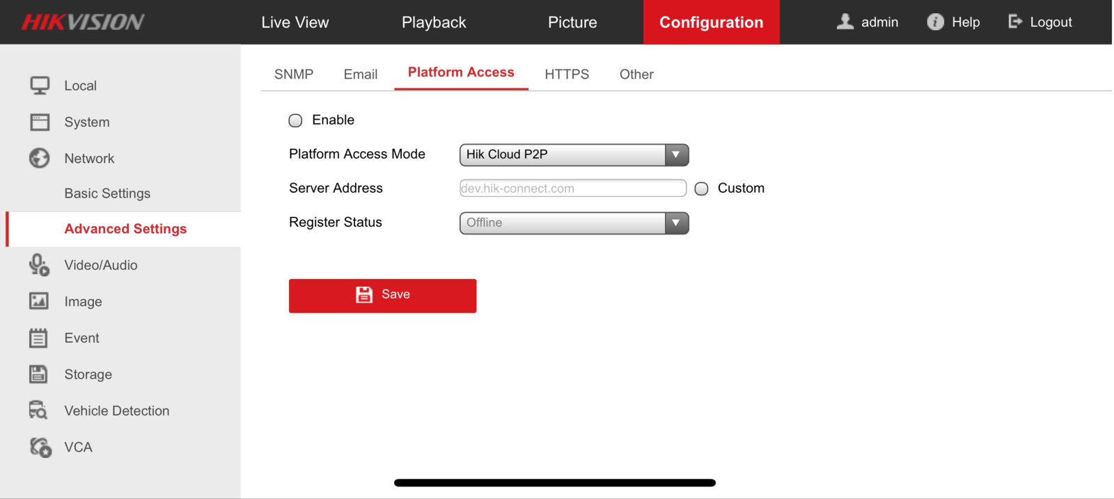

Thanks. I've found "Platform Access" but don't see the "Verification Code"? On the monitor connected to NVR, the Verification Code features on the Platform Access screen.
I believe you have to enable it to see it. Other than needing the code for the app I have not needed it and when I got the code I wrote it down from the label on the bottom of NVR.
