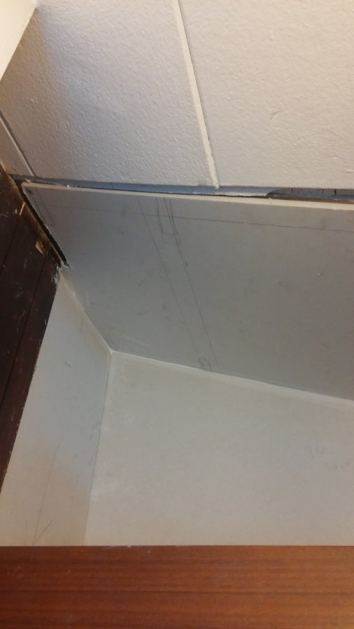

Can I repair this or best to go Professional?
Is all that damage in the ceiling below that little slate roof, because the roof looks to be in a right state, with no flashing too
Had someone call out today. He had a look at the damage from the inside and said just get a plaster out to stick some plasterboard on it and then skim over, he then said I could do it myself. He wasn't too bothered about that. I said the leaking has stopped but he said the roof all needs removing and the slates which can be saved will be used and then reroofed with new battons etc with new and existing slates. Will be getting the quote through in a bit.
He said on a low sloping pitched roof you should not use tiles but keep to existing slates.
No one is bothering which such a job - the good ones are too busy to do small work and the ones that are available are not turning up. So reading up, is it best to go with a plasterboard plus multifinish or just use bonding plaster for the ceiling?

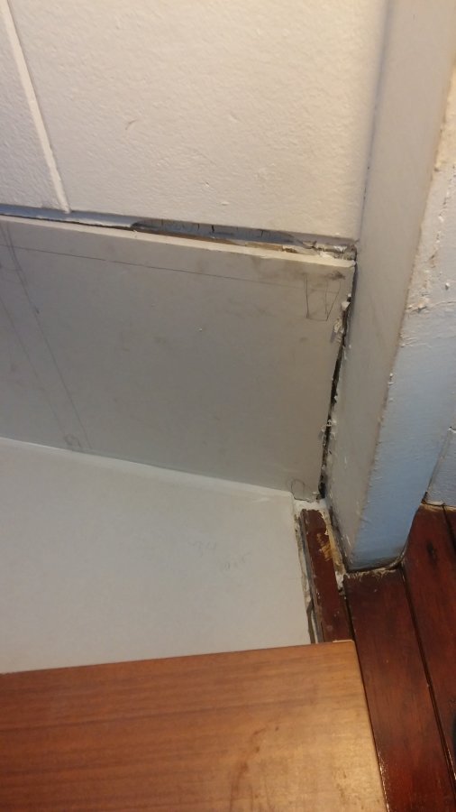

So I attached some roof batten to the lathe and plaster ceiling and then used Siroflex SX Mighty Strength to glue the plasterboard to the ceiling and walls - now I have some gaps, whats the best way to fill these gaps? Use standard filler or something else?
I know I have to apply plasterboard joint tape on all the corners and edges. But whats the best way to fill in the gaps? Use sealant or decorators caulk?

Its hard to advise you when you dont appear to listen to whats been offered. But for what its worth:
Your plaster boards are very neatly cut in and fixed.
However, you seem to have simply covered over much of the damaged woodwork and neglected to treat what could be dry rot or some kind of fungal damage in your ceiling.
Using roof laths is wrong and your plaster board has now become proud to the surface under the polysterene tiles.
You can use any kind of filler to bridge the gaps then tape over.
Your problem was and still is the lower roof area directly above the damage.
I can now see a photo of the lower roof and, as above, it needs renewing.
You might find if the roof is opened up that your recent efforts will need re-doing.
Given the dark splash area in the photo, has your neighbour complained of a damp wall?
